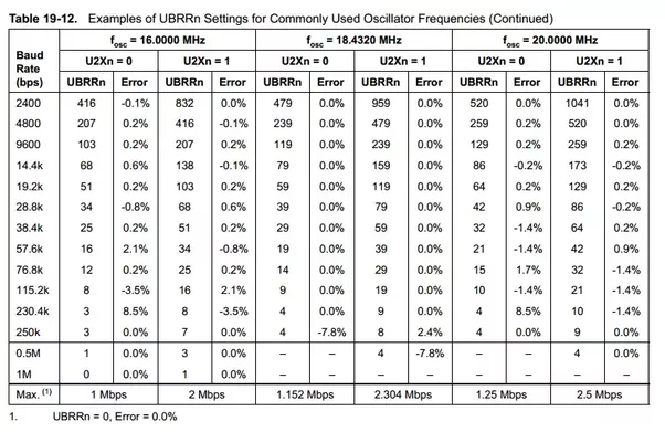

Take a look at this image:

Thanks for the replies.
I'm receiving the Arduino's serial data on a python program using pyserial for data logging.
Here is a test code that works just fine on the CH340 boards:
