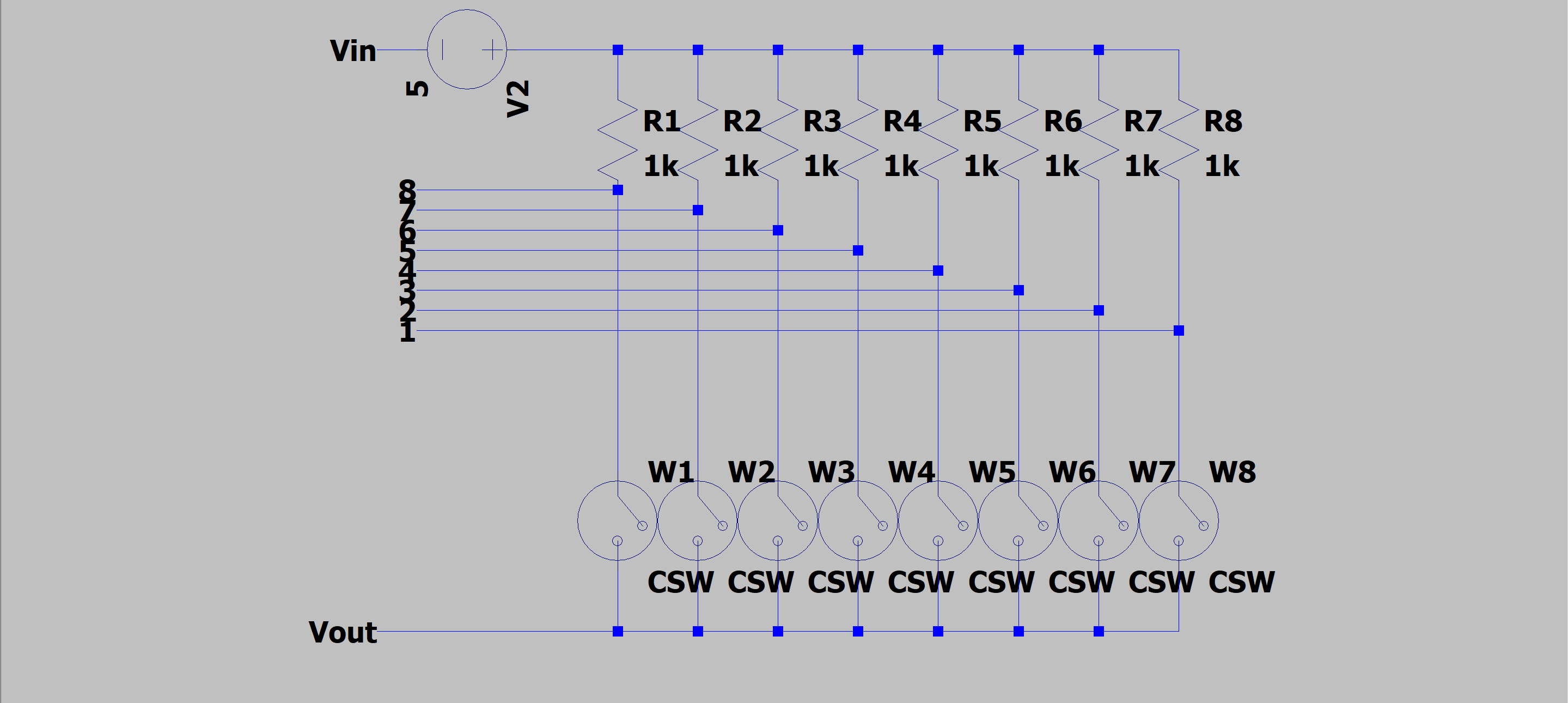

  • The OP labels the common on the switches Vout
  • Do you have Vout connected to GND .
  • Do you have 7 or 8 switches.
  • Input pin D1 is used for communications.
  • Time to have an accurate schematic, please supply one that matches your sketch.

We removed 1 switch indeed. I remembered we used 8, but at last minute we decided to now go for 7 since we removed the switch connected to digital pin 2. I forgot I pasted the code we used for the 7 switches.
I also see that in the code I pasted I have indeed removed the delay after each reading each switch. We have had a delay(10) (so 10ms) in the past in the first if statement of the loop. So I will give the full updated code we are going to try tomorrow. To be honest I don't think it will change anything since we have tried it in the past.
The switches are wired so that they are always high (1) and when pressed are low (0).

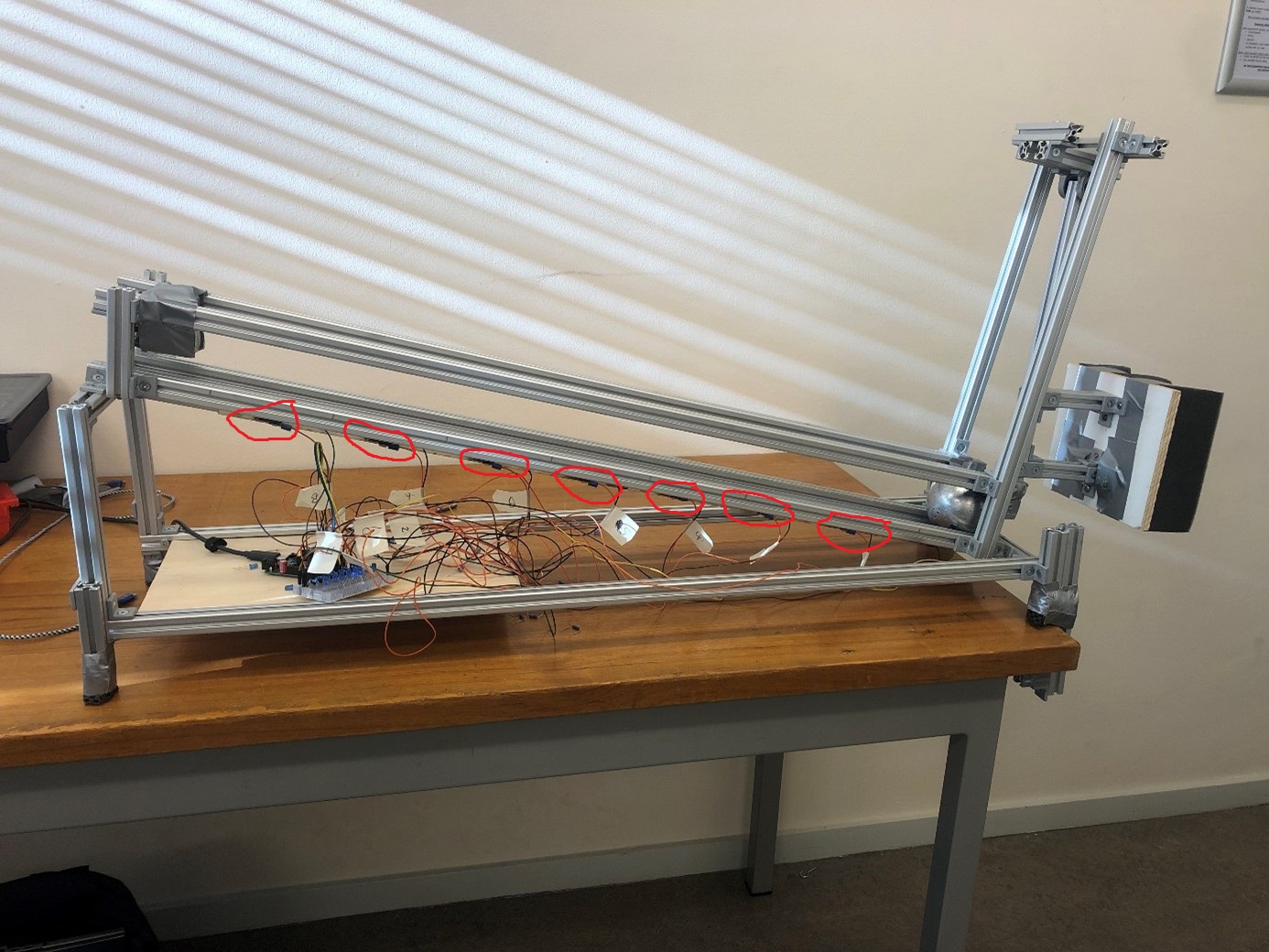

A view of our setup:
Marked in red are the switches we now use. Also to exclude slipping we have gone from a ball to a pvc cillinder now. But that didn't change the data as mentioned. On the picture is still an iron ball. I will show tomorrow a better picture of the setup. We didn't have much time to update the picture of our setup last friday unfortunately.
What exactly does the setup do? Looks like possibly the arm with a white/black block on it hits a ball, which rolls up the slope, then back down again. Or does it operate opposite to this, with the ball being released at the top and measuring the timing as it rolls down the slope?
Yes, the arm with the white/black block pushes the ball (which is now a cilinder) up on a slope. So we start at the bottom and the cilinder moves upwards.
Eventually we want to use the measured timing between two switches to calculate the speed. Those speeds we can (curve)fit with a model. This will give us only 1 speed which we will later use to calculate what the impulse given to our setup was. We will calibrate the results with a pendulum and have calculated for different weights what the impulse would be when no energy is lost.
So it looks like you really only need to measure the switch intervals on the way up in order to do the calculations.
This is not required with the switch configuration you have, and I would remove the delay(10).
