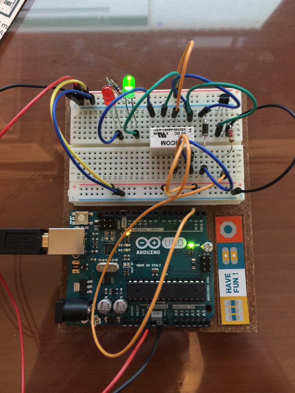

My goal is to make a circuit that can turn on my gas fireplace with a remote control. So I've got the infrared stuff working, but I need to get the relay switching figured out. So I've wired up CIRC-11 circuit, but I can't change the delay of switching (it defaults to 1000 milliseconds) the green and red lights just flip back and forth at the same rhythm. I also can't make the circuit do anything on any other pins besides 2, even though I change the code properly.
Any ideas?

Photos of wiring are generally impossible to figure out reliably. Make a pencil drawing of the connections and post a photo of the drawing.

Have you accidentally posted the wrong program? That code is just the demo for blinking an LED
Also it does nothing for 1000 millisecs - both delay()s are for 4000 millisecs.
