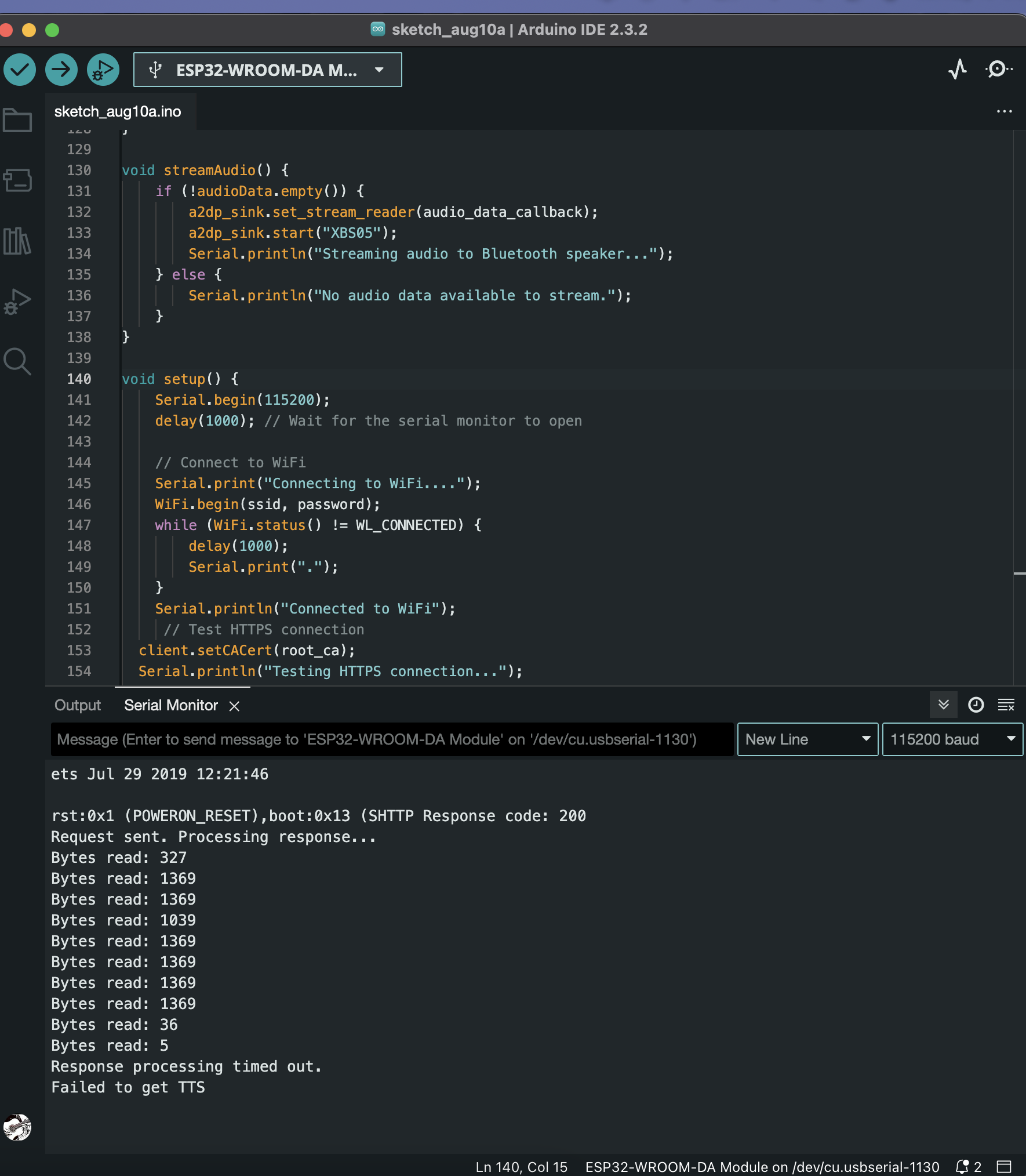

Hey! I am using Open Ai text-to-speech API to process the serial input text and convert it into audio. The request is sent to the API, and the audio stream data is received, but while processing the data, I get a Processing timed-out error. I initially had the timeout at 30 seconds and the buffer size of the audio at 1046; now, at 3 minutes of timeout and 4096 as buffer size, I’m still getting the same error. I am confused as to why I keep getting the same error even after that much processing time.
For your information, I’m using the ESP-Wroom-32 Module and Open AI’s Text-to-Speech API.
The goal is to process the audio file and output it through the Bluetooth device that I have.

bool getTTS(String text) {
if (WiFi.status() == WL_CONNECTED) {
Serial.println("WiFi is connected. Sending request to OpenAI TTS...");
http.begin(client, serverName);
http.addHeader("Content-Type", "application/json");
http.addHeader("Authorization", "Bearer " + String(apiKey));
String jsonRequest = "{\"model\":\"tts-1\",\"input\":\"" + text + "\",\"voice\":\"alloy\"}";
Serial.println("Request JSON: " + jsonRequest);
int httpResponseCode = http.POST(jsonRequest);
if (httpResponseCode > 0) {
Serial.print("HTTP Response code: ");
Serial.println(httpResponseCode);
if (httpResponseCode == 200) {
Serial.println("Request sent. Processing response...");
WiFiClient *stream = http.getStreamPtr();
unsigned long startTime = millis();
const unsigned long timeout = 180000; // 60 seconds timeout
const int bufferSize = 4096; // Adjust buffer size as needed
std::vector<uint8_t> buffer(bufferSize);
while (stream->connected() || stream->available()) {
int available = stream->available();
if (available > 0) {
int bytesToRead = min(available, bufferSize);
int bytesRead = stream->readBytes(reinterpret_cast<char*>(buffer.data()), bytesToRead);
audioData.insert(audioData.end(), buffer.begin(), buffer.begin() + bytesRead);
// Reset the timeout timer
Serial.print("Bytes read: ");
Serial.println(bytesRead);
// Check for timeout
if (millis() - startTime > timeout) {
Serial.println("Response processing timed out.");
http.end();
return false;
Serial.print("Total audio data received: ");
Serial.println(audioData.size());
http.end();
return true;
Serial.println("Request failed. Check the response body.");
String response = http.getString();
Serial.println("Response body:");
Serial.println(response);
Serial.print("Error on sending POST: ");
if (httpResponseCode == -1) {
Serial.println("Connection failed - Please check SSL setup or connection.");
Serial.println("Unexpected error.");
http.end();
Serial.println("WiFi Disconnected");
return false;
