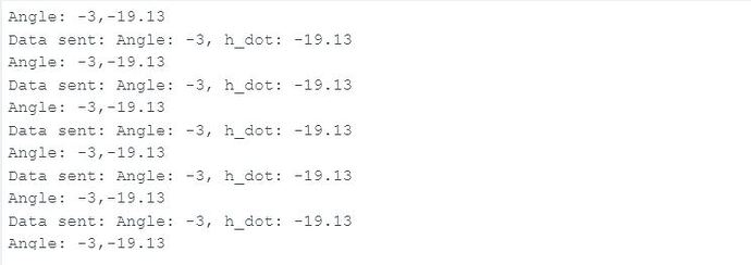

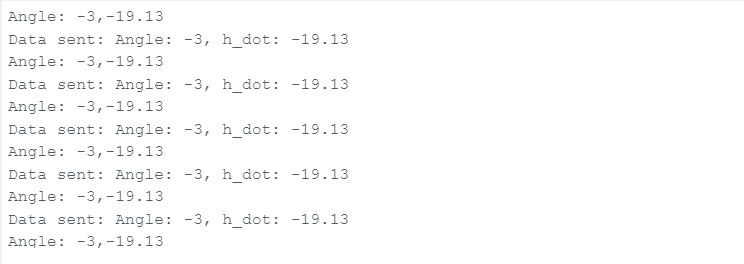

the arduino is giving me this result which is perfectly when i move sensor the angle and h_dot changing
sorry for image
to make sure that arduino printing on serial i modify code usin these lines
 // Print the data being sent
 String data = "Angle: " + String(angleZ) + ", h_dot: " + String(h_dot, 2);
 Serial.println("Data sent: " + data);

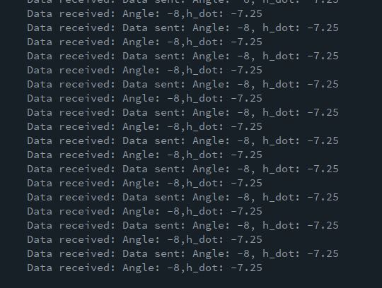

some changes in arduino code i did please than now in processing i get this , apologize for picture
import processing.serial.*;
Serial port;
float angle;
float h_dot;
  size(400, 300);
  printArray(Serial.list());  // Print available serial ports in the console
  port = new Serial(this, "COM5", 9600);  // Replace "COM5" with the appropriate port name
  port.bufferUntil('\n');  // Set the character to buffer until newline

void serialEvent(Serial port) {
  String data = port.readStringUntil('\n');  // Read the received data until newline character
  if (data != null) {
    data = data.trim();
    println("Data received: " + data);
Capture
OK so what you have to do is to parse the data out of the string you received into real numbers so you can use them to change the Processing display.
