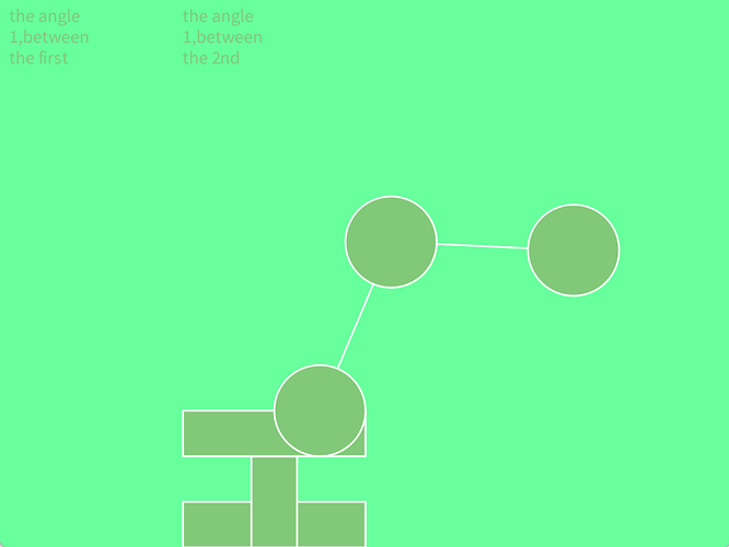

Hi
I am working at an intrestiing project,i want using the processing to control a robot arm,i would drew a picture to show how the robot arm move ,like this
but there is a little difficulty,i want transmit the two data about the angle between the two circle and the original point at once,i don't know how to use the processing transmiting the data of array to arduino ,and how can i make the arduino recieve the signal.
and here is the processing code

Hi @jerrl ,
it looks as if this part of your Processing sketch has been written to supply the data byte per byte to the Arduino sketch
int[] x = {a_1, b_1};
  // 发送数组到串行端口
  //for (int i = 0; i < x.length; i++) {
    // 将整数转换为两个字节并写入串行端口
    //port.write((byte)(x[i] & 0xFF)); // 发送低8位
    //port.write((byte)((x[i] >> 8) & 0xFF)); // 发送高8位
but the required statements have been changed to comments.
I'm not completely familiar with the Processing syntax but you may try this
  // 发送数组到串行端口
Good luck!
ec2021
[Edit]: And you have to initialize the Serial port of course; that's the first line in the Processing setup() function:
 //port=new Serial(this,"COM5",9600); //Arduino板的端口号
Uncomment this line also and make sure that the COM-Port addressed is the correct one for your application

hi,thanks for your answer,i already work out this problem,i always think about the question is there is something wrong with the code of recieve or the transmitor,but the fact that is the Serial need some time to answer the calling of processing,so i just add a code" delay(1000)",than everything is ok
