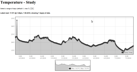

php is a easy route to take as it is simple to carry out the plot as there are a lot of libraries out there that does the graphing for free.
here is one post that demonstrates the same .
http://scouris.wordpress.com/2010/09/10/temperature-sensing-with-arduino-php-and-jquery/
hope this helps !
