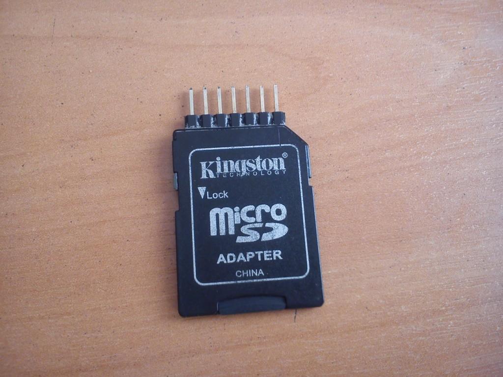

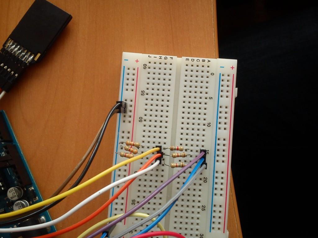

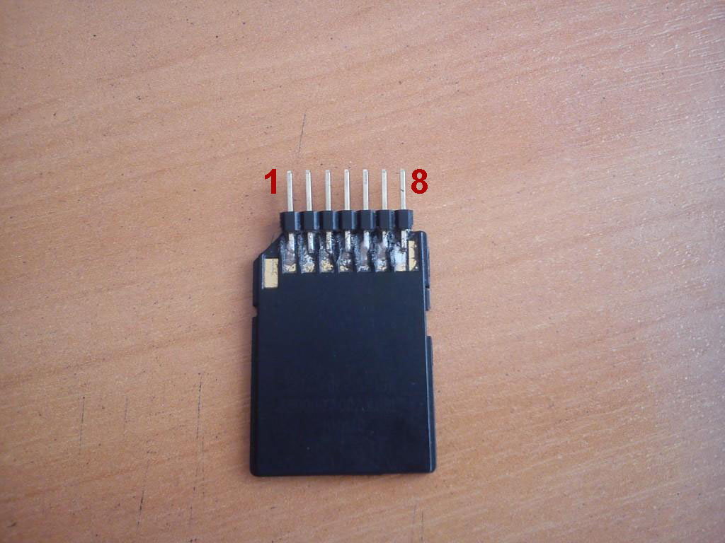

Program can't open file on SD card
Hi guys, i've a problem. I've made a sheme with 3 OneWire devices DS18B20 and a self made microSD shield. An idea is - find all OneWire devices, register them in a table, ask each one 1 time in 5 seconds 12 times and print data to a serial port (port monitor of Arduino IDE) and to a file on microSD card. If i comment a part of program which write data to a file, all the devices are found, table and temperature data from them printed to a serial. When i try to write it parallel to microSD, programm write "error opening test.txt", BUT! if the file was not on microSD card, it magically appears with 0b size. If i try to write a simple data with a simple programm to a microSD card like "test 1, 2, 3" whithout any changing in wiring it works great. File appears, data writing to it and so on. Please help me, I'll be glad for any suggestion.

Here is my DIY micro SD shield:

And the scheme:
To everyone.
And the pins:
Micro SD adapter can be installed directly on breadboard. It has a same pin step.
So it is. Cheap and useful.
