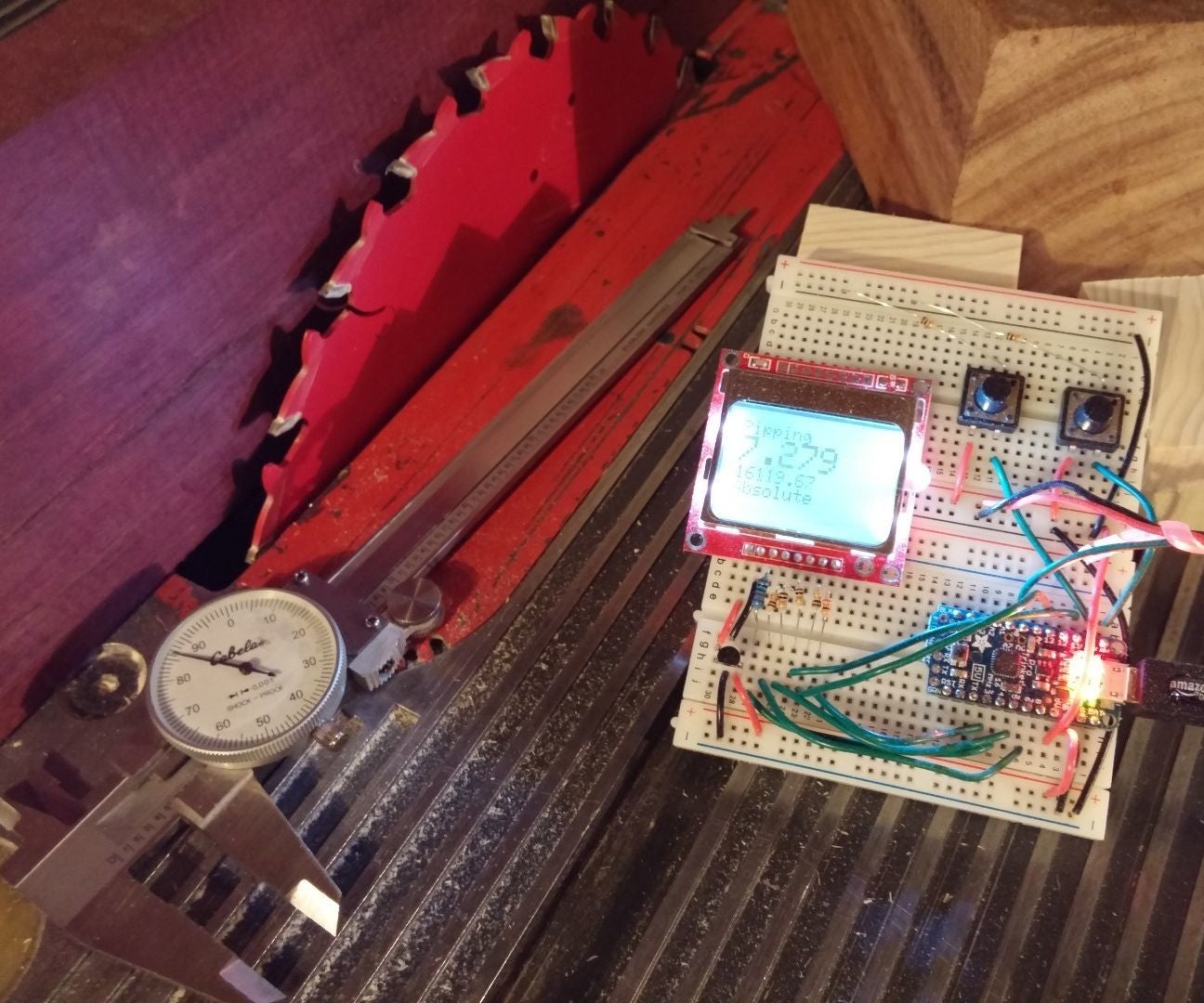

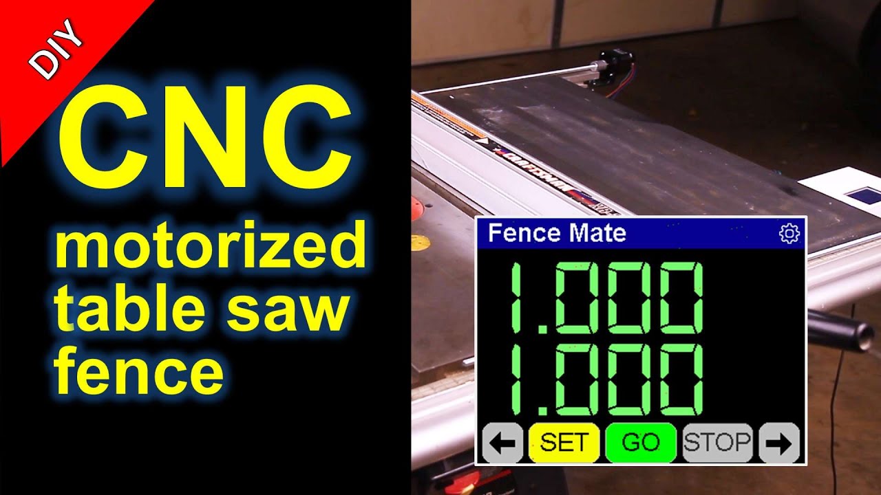

Here are some motorized saw fence and Arduino based digital table saw projects. You can proceed by combining these ideas:
