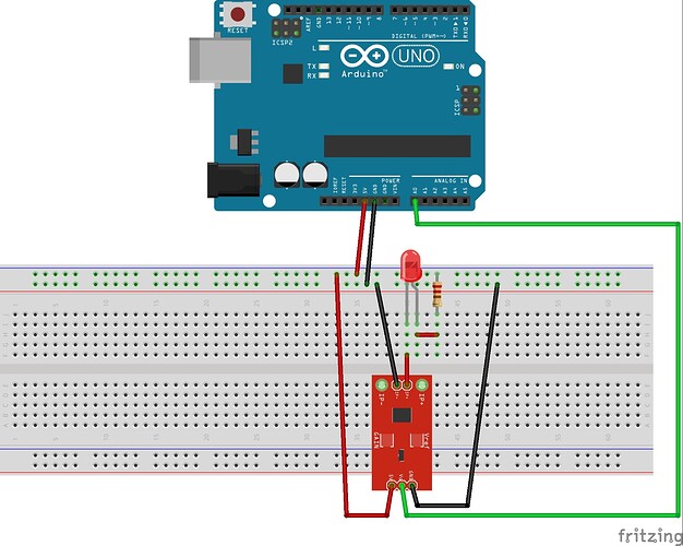

what i am trying on the long term is a device to measure the capacity of a battery and display it on a 7 segments later on in percentage display .
So i started first to learn about the Current Sensor which I have and it's the ACS712, you can check it on this link
now i made a small arduino program which give me the voltage of an LED connected to 5V power, please check the schematic using Fritzing in the attachment files
below you will find my sketch which shows the Voltage on the LED and the step voltage for each bit from 0 to 1023, i would like please to know your opinion if it is correct, the red LED voltage is 2V and the resistor is 1K and not the 220 ohms on the schematic (because i couldn't find a 1K resistor in fritzing)
next step is to calculate the consumption over time, so many question i have about that:
1 - when i made the calculation by hand to find the current i got I = 3mA = 0.003 A, does this means the LED is consuming a 3mA per hour instead of the 18mA that should get according the datasheet ?
2 - when i calculate this over time, would the final answer stays when i turn off the arduino ? (i think not) so how can this be done if i need to make a detector for the battery capacity percentage which should always be there when i turn off the circuit and then on ?
here is the sketch:
It consumes 3mA, full stop. Not "per hr". mA is an absolute value.
The timed consumption is 3mAhrs. IE, 3mA drawn for 1 hr. 72mAhrs per day etc.
With 2v across the diode there is 3v across 1k so it is passing 3mA.
When you turn off the Arduino you need to save your value in the EEPROM before turning it off.

For the value read, we would need to see a drawing of the circuit that the sensor is wired into.

about the circuit i put one above with fritzing

i still have 2 more problems here which i need to make sure if it's right or wrong:
1 - i am getting these values for current, which looked a bit weird to me if we go back to the schematic from fritzing which i shared up top, 0.25A ! is this real ?! all i have is an LED connect to +5 and a resistor, the current it gets from arduino +5V pin, and why it started by the 0.08A first ?
2 - the second is about using the Float data type, is there any other way of getting it ? or i think there is by making the rest calculus but would it consume more time according to the float or less ? (i can do the rest method becuase the final result will be shown on a 7-segment display so it is easy)

  Vout = (data * 5)/1024;
So, Vout is the average of the input values, converted to a voltage. I guess, then, that you'll be computing Vin to use as an output.
  float  amps = actualVal*10 ;
Current, in amps, is voltage times resistance in Ohms. So, the current comes from a 10 Ohm resistor. Is this true?
PaulS:
Vin = 5V or 5000mV but i used 5 in Vout inside the parentheses
is there anything i missed ?
PaulS:
this one i got it from the instructable link, as i understood he multiplied by 10 just to convert from for example 0.2 to 2
Multiplying 0.2 volts by 10 does not produce 2 amps, unless the 10 is 10 Ohms.

i managed to make a more simple sketch, turns out it was very simple task but i wasn't seeing clearly, i should just get the ADC value and multiply it by the 5 volts voltage divided by 1024 then subtract the offset voltage and divide by the scaled voltage, below you can see the sketch i made but i am having a trouble with the values i am getting on the monitor for the current, if i do hand calculation for the current through the LED :
Power voltage = 5V
red LED voltage = 2V
270 ohms Resistor Voltage = 5 - 2 = 3V
I = Vresistor/resistor = 3V / 270 ohms = 0.0111 Amp
(for schematic it is the same schematic i shared in the beginning of the post)
now when i see the results on the monitor, i am getting :
Analog Value = 513
V = 2.50488
Amps = 0.02639
Analog Value = 514
V = 2.50977
Amps = 0.05279
Analog Value = 515
V = 2.51465
Amps = 0.07918
about the analog value if i make an average value with for loop, things are getting messy and i get a very high amp value around 0.25 or more so i kept it without analog average value.
so i need to know please why i am getting a higher amps results than the one calculated by hand ?
