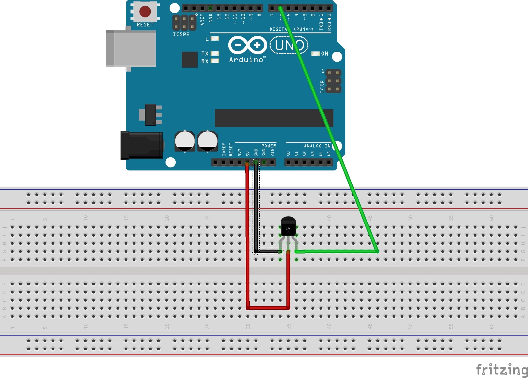

I'm working on a digital thermometer and I have two working separate sketches for a DS18B20 temperature sensor & LCD 1602. I need help merging them.
(Note: The attached file picture below is a lm35 part for visual purpose only as i can't find a DS18B20)
First Sketch DS18B20

Here's the LCD code and wiring. It's a Hello World code.

First thing to check for is pin conflicts- this should be obvious if you try to wire everything up whether the 2 pieces of hardware are trying to use the same pin.
Once you have all the hardware wired then try to run each sketch individually on the merged hardware. This will confirm you have no hardware conflicts.
If this succeeds then you can try to merge them: create a new empty sketch, copy the #includes and other heading stuff from both sketches into the new sketch and try to verify- this will test for software conflicts within the libraries used.
Assuming that went OK copy the setup() and loop() code from the existing sketches into the corresponding sections of the new sketch and try that.
If thats OK then you probably can change the lcd.print(millis() / 1000); line to print out temperatures instead..
If you get stuck at any time then post your actual code and error messages back here and people will try to help

I changed/deleted some things on the above merge code. Only problem I have left is:
1.) How to retrieve my temperature readings (Fahrenheit/Celsius) to display on my screen as my temperature readings is displaying in the "Serial Monitor".
RIght now my LCD is displaying this but no values:
Celsius:
Fahrenheit:
Re-vised Code:

Anybody?
crvtec:
Celsius:
Fahrenheit:
That is because you have instructed Arduino to print the text to LCD, but have neglected to instruct it to print the values.
The values you see on monitor may be 85. This is because you have not provided any delay in order for the DS18B20s to get the readings sorted.
Thanks for the replied.
I assume I have to input something after the colon on this part of the code " Celsius: " and " Fahrenheit: " to get the Temp?
Code
lcd.setCursor(0, 0);
lcd.print(" Celsius: ");
lcd.setCursor (0, 1);
lcd.print(" Fahrenheit: ");
NVM sir...I got it working. You got me put on my thinking cap. Thank You Kind sir
