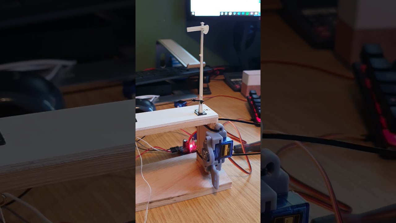

Hi Bob
Right, had a bit of a play with that and also updated the mechanical side with a servo mounted cam type thing...
I noticed an error in the "case AT_CLEAR" section where the bounce percentage used was the danger one...
sigVars[s].bounceDistance = (signals[s].clearPWM - signals[s].dangerPWM) / (100 / signals[s].dangerBouncePercent);
but changed this to the 'clear' version and all seems well.
I'll put the code below but the signalDefs I am using in the video also posted below are:
{ 5, 360, 200, 2, 2, 2, 130, 4, 50, 100, 2, 20 },

The bounce in the video doesn't look too bad but it depends on how far you want to take this
Well i think variable speed, acceleration and deceleration, would greatly add to the realism.

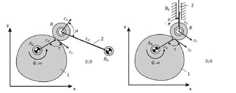

Looking at the addition of the cam mechanism, and correct me it I'm wrong, i think weve increased the bounce magnitude (in PWM terms) by about x4. Is this sufficient to allow us to introduce speed variation? If not I'll revisit the mechanics of the movement to see if I can get a greater PWM range.
I will give acceleration/deceleration some consideration but I am not convinced that it will make things more realistic at the scale we are talking about
There is also the complication that 4 types of change of speed while bouncing would be needed if aiming for perfection
  1. Lower quadrant signals at danger
  2. Lower quadrant signals at clear
  3. Upper quadrant signals at danger
  4. Upper quadrant signals at clear
In each case the effect of gravity would be different due to a combination of the direction of movement (up or down) and the angle of the signal arm (90 or 45 degrees)
I'm not sure we need a distinction between upper and lower quadrant signals TBH as the mechanics related to their operation are pretty much the same only the direction of travel alters. If you accept that the dangerPWM is always greater than clearPWM the servo mounting can be reversed or a lever added if the signal direction is different. As for the movement the signals are weighted to the danger position and therefore during and at the end of a movement from clear to danger there is a release of tension and the most apparent bounce (signal arm hitting a physical stop). Moving from danger to clear is likely slower, with hesitation and a smaller bounce (tension/stretch in cable related movement).
I looked in just now to see what is up. I think there is no good chance of programming a servo to give anything like a realistic bounce.
Why not just make the mechanical linkages less rigid, to try to physically obtain a bounce out of the equivalent of tension and stretch and such things as are present in the real system?
It would also not be precisely the same wiggle every time.
A few rubber bands and strategically placed weights coukd do it.
If this have been mentioned, never mind. I did just let a few dozen posts scroll by until I saw the latest video.
a7
It has, (no need to apologise with a topic of this size) but the idea was rejected by @gingerangles in favour of removing slop in the system and programming the servo to create realistic movements
I, however, am not convinced either that the slop in linkages can be removed or that a servo can be programmed to provide a realistic bounce especially as originally envisaged there was very little servo movement between clear and danger. This meant that the bounce distance was very small and dividing it into a series of diminishing bounces meant that there was no real chance of programming acceleration/deceleration into the bounce movement
@gingerangles has subsequently changed the mechanics of the servo connection to the signal so that the servo movement is larger, I have not yet analysed the effect on the size of bounce movements but I suspect that it will not have made enough difference to matter. If anything the revised mechanics of the servo to signal linkage may have made the bouncing more realistic in itself
It's late in the game but, what about a rotating cam 'programmed' with bouncy movements cut into the periphery a la
Use a stepper or geared-down DC motor.
Thanks for the input all. I can't help but reference back to one of the original videos which kicked me off on this quest...
Driving Semaphore Signals with Servos (Video#55) (youtube.com)
Particularly the results obtained at 19:45 to 20:30.
I've tried to understand the code, however it's well beyond me for the moment... I think there may well be some significant maths behind the scenes as well which I assume is embedded in the code but the code is part of a larger project, as far as I can tell, which includes all sorts of other bits and bobs to interact with computer and "DCC" control systems for model railways.
For what it is worth I'll post the sketch provided by the video's author below, perhaps it may be of some usefulness?

Hi, My first post. Been having a read through this as I'm wanting to replace the built in motor on a Dapol Signal with a servo (The original Dapol retailed signals used some odd setup where it didnt remember the "state" as it worked on simply breaking a wire to change between "on and off")
During Covid I worked out a stepper motor for a turn table, using a hall switch as a reset point at start up, so thought.. Hmm, this would be easy, but alas, when I started having a look and found what your doing here I see its a little more complicated than I was expecting. I've now got to try and unravel what has been written to see if I can make good use of your project as I was most impressed..
Can I clarify, are you controlling 2 signals ? (which will be perfect later on)
Which pins in the end have you used as triggers ?
Have you given any thought to the "pull" having a moments rest as some do as the signalman pulled the lever off the latch ?
I'm looking to uses an ON/ON SPDT Switch. Along side the servo arm will be two mirco switches to work a real signal repeater to be mounted on a shelf to show the same state as the layout signal (this is a separate circuit and not via the Uno R3 board)
I'm not far down the road from you on the Robin Hood Line, just the other side of Mansfield
Best Wishes
Andy
