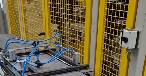

The project I am working on is an unwinding table: this table grips material and while it is clamping, a heat wire is applied that "welds" the material together. Then the material is pulled forward after which it is cut off by another hot wire that should go out after x seconds. Then the clamping plate goes up and back again to the beginning. This schematically looks like this.
I got it working by simply controlling the relays via different delays. The goal is to make it work through sensors.

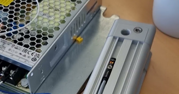

There are 2 sensors on each cylinder at the end stops.
To read the sensors I used an opto coupler because the sensors work on 24 volts. The code to read it and drive a relay looks like this: (this was a standard piece of code that I modified a bit)

The intention is that the system will work by means of the sensors that must be active in certain steps in the process in order to proceed to the next step. (see excel picture)
Video down below is to show the setup with a sensor.
