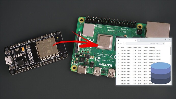

I am a beginner in Arduino and I bought an Omron D6T 1A 01 temperature sensor. I'm just having trouble with information and knowledge as well. I have Wemos D1 mini microcontroller based on the esp8266 module.
My plan would be to run a database on a raspberry and a D1 mini send a temperatue data via wifi.
Here is a picture that properly explains what i want.
I found an excellenet tutorial about it but not my sensor and not my microcontroller. Here is the link.
So I think I need to merge my code and the code in the tutorial. (5. step) I attach my omron code.

Can anyone help me with this? Thank you very much!
Please show the sketch on this forum. Put the sketch between code tags, that is the '< / >' button.
After you have posted, you can see the link to your attachment. Then you can "Modify" your post and insert a picture with a link to your own attachment. That way the picture is shown and we don't have to open attachments.
Give also links, picture, photos, schematics and drawings :o Even if it is only to give us an idea what you are doing :wink:
Omron D6T-1A-01: http://components.omron.eu/Product-details/D6T-1A-01
It seems that it is a 5V I2C sensor. Is that correct ? The ESP8266 runs at 3.3V. Is the I2C bus from the ESP8266 compatible with that 5V sensor ? Is that specified somewhere in a datasheet ? I can not find that. If that is not mentioned somewhere, perhaps you can ask the manufacturer. Maybe a I2C level shifter is needed.
Is your sketch working ? Have you confirmed that the data is indeed what you want ?
The database is on the Raspberry Pi, so all the complex things are on the Raspberry Pi.
You should make a database with data that is for your sensor.
The database is now for: "sensor, location, value1, value2, value3, reading_time".
I know almost nothing about a MySQL database. If you have questions about that, then you can try the forum at raspberrypi.org or stackexchange. I think the nerds at stackexchange are the most eager to answer your questions :wink:
The ESP8266 reads the sensor and uploads the data, that's all.
In the sketch, the line "Serial.println(httpRequestData);" uploads the data.
So you should check how that is created:
String httpRequestData = "api_key=" + apiKeyValue + "&sensor=" + sensorName + "&location=" + sensorLocation + "&value1=" + String(bme.readTemperature()) + "&value2=" + String(bme.readHumidity()) + "&value3=" + String(bme.readPressure()/100.0F) + "";
That is the part that works together with the database.
First of all thank you for your answer.
I think it works with 5V because my sensor works fine. I got perfect temp data.
I merged my code with his code. What do you think about that? It can works? I can't call a bme.gettemperature...
