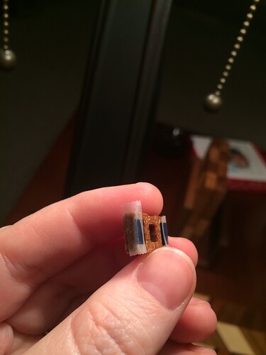

I suspect I’m a bit late entering this thread - but I’m having difficulties attaching the coloured gels to the photoresistors - the wood-type holders don’t fit in a sensible way and tend to slide down the resistor legs. Moreover I don’t think there is enough room for them with the resistors placed where they are in the book diagram.Help - if you’ve managed to complete this project I’d like to know how!
alechk: I suspect I'm a bit late entering this thread - but I'm having difficulties attaching the coloured gels to the photoresistors - the wood-type holders don't fit in a sensible way and tend to slide down the resistor legs. Moreover I don't think there is enough room for them with the resistors placed where they are in the book diagram.Help - if you've managed to complete this project I'd like to know how!
Thank you for highlighting the wood holders; I was having a hard time figuring out what the gel "holder" was supposed to be based upon Fig. 2 in the project.
I ended up using tape to secure the short "tabs" of the gel that ended up poking through the underside of each side of the wood holders . By taping them, when I slipped them on the resistors, the gel was no longer pushed out of the holder and the holder doesn't slide down the sensor.
And you are right, with the holders slipped over the resistors, the placement cannot be perfectly replicated as shown in Fig. 1. So I have the LED in rows 4-7 of my breadboard (the cathode is in row 5). The photoresistors are in rows 17 (red), 24 (green), 30 (blue), but am realizing even that may be too close as it doesn't allow me to easily direct a light source onto just one sensor, so I may end up spreading them out further. Things seem to be working with this setup (LED lights up and changes color a bit) but I need to tweak things more to get proper color response.
As long as power, ground, resistor, and pin connections are still maintained to the new rows; it shouldn't be a problem to move the resistors further apart.
I don't know about you, but in my case, the widest dimension of the photoresistor is just a wee bit wider than the smallest dimension of the hole in the holders.
So I put the resistor through all the way, twist it 90 degrees and then gently push it back down into the wood.
But I can totally imagine your wooden holder to be just a little bit bigger.
Either way, I found that the setup as given has some problems.
First of all, the sensors are too close to one another to be able to really control the light of the LED.
And second, the LED itself tends to shine on the sensors.
Maybe an easy hack: find a ballpoint pen (a yellow Bic might be ideal), cut it in 3 hollow poles, make a cut in them ALMOST all the way through. Put the gel into the slot you cut, put the poles over the sensors.

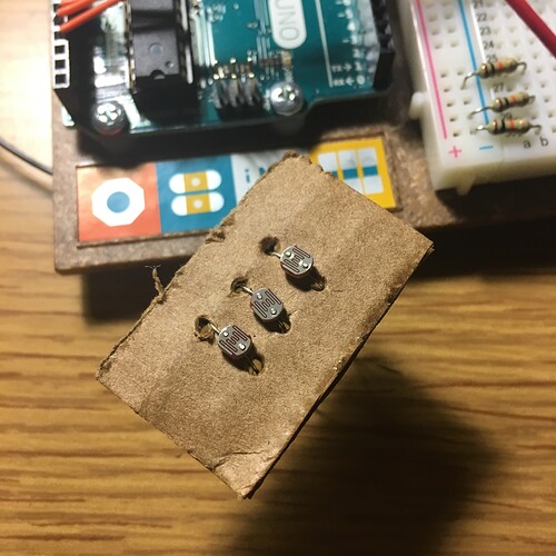

I finally got back to working on the project and I think I found my problem, or at least a clue.
If I turn the photoresistors around, so the cathode is on the side with power, everything works fine. Maybe I have something else backwards?
You're not alone, davidlrf, I had the same problem. I couldn't get this project to work either until I turned the photoresistors around so they're backwards compared to the book. I can only assume the wires were cut wrong... for me the short leg is anode, the longer cathode.
And the gels they give you are completely useless, you can't even do what they diagram in the book (using the wooden E pieces)... perhaps they changed the design without updating the book? Edit: discovered this is indeed the case, the LDRs they use now are different.
Yes. I took one look at the gels and the plastic pressboard fixtures and said "nope." So I built a little gel cover with cardboard, hot glue, and tape. Photos below.
As for the circuit. Like others, I got nothing from the LED when I ran the sketch. I just pulled the 220 ohm resisters out and it worked. I've tinkered around with it enough. Moving on. :)
