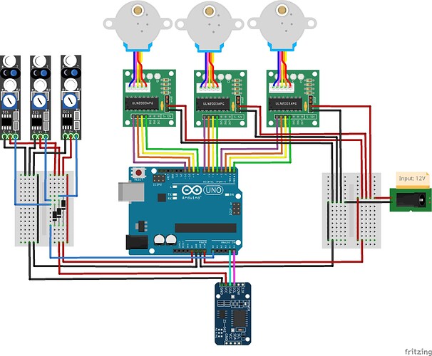

I tried to make a fritzing overview. As "endswitch" I used KY-033 modules. Is a DCF77 really needed?
Instead of the breadboards I plan to hardwire everything.
Any feedback?
A hand drawing, with pencil or pen and paper, is vastly preferred on this forum. Especially if the pins and parts are properly and clearly labeled.
What is all that stuff on the left side of the drawing?
Only if you want an external time reference. You could just use an rtc module but would need to set it, or ntp via wifi.
I found on amazon this modules, named KY-033. I would like to use them as endswitch, so that the clock is able to initialize automatically after power on.
Those look over complex to me. Standard slotted opto interrupters woulld be fine.
