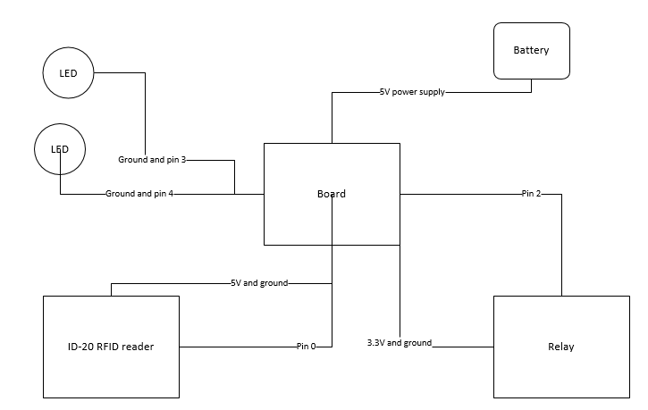

Hi
Can you please post a complete copy of your circuit, in CAD or a picture of a hand drawn circuit in jpg, png or pdf?
This means including you power supplies.
Tom.... :slight_smile:
Is the attachment ok?
Sorry a circuit diagram, showing individual wires, a picture too would help.
Have you got current limit resistors in series with each of your LEDs?
Have you checked on the current required to fire one of those RFID units.
Do you have a DMM?
Is this better, i just downloaded it can fully use it yet.
What model is your RFID reader and what are its specifications.
What is its current when in transmit mode?

How do you tell if the scan is failing if BOTH success and failure flash BOTH LED's at same rate?
Does "it is not working" means no LED flash at all ?
If so - check you power AGAIN.
With two LEDs you could get little more inventive with error indicators.
It seems to me that if the project works as intended while connected to computer via USB that any sort of programming error can be ruled out.
Seeing as how the USB port is providing 5V, and your project drawing indicates use of 3.3V one could also safely assume that a voltage regulator is in place, it would further make sense (but would need to be actually verified on the board) that the connector for battery input uses the same voltage regulation circuit as does the USB connection, because why would there need to be separate circuits to handle the same job.
I feel the most likely culprit here is back EMP produced when the relay is deactivated. The collapsing magnetic field induces reverse voltage back into the power lines unless some form of protection is used (a diode). I am thinking that the computer manufacture anticipated that at some point a device may induce unwanted voltage on the USB power lines and took steps to protect the port (once again a diode). I have not actually tested such a thing with my computer, but I do know from experience that if I cause a short in the 5V lines the computer will deactivate the port until it the next reboot.
Without this protection (when you are using battery connector or a USB battery pack) when the relay deactivates it is likely producing a reverse voltage spike on the power lines that either causes a reset or creates enough of a brown out to cause program execution to halt.
If you do not have a diode in place on your relay it may be worth looking in to, simply Google "relay back emf" and I think you should find the information you need to implement this.
When i scan the both LED's light which tells me the reader has picked up a card, this does not happen when powered with batteries but works flawlessly when plugged into the USB.
BH72:
Thanks for the info, what i will do is remove the relay to see if this solves the problem.
markmonkey:
I was going to make that suggestion; however, I did not want to suggest it in case it turned out to be a total hassle for you to do!
