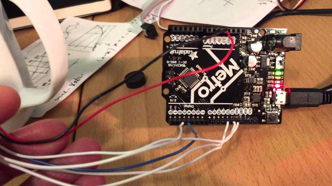

I'm working with older PS/2 mice for X Y tracking distance/ displacement for a small robot I've built. The PS/2 code is working tracking mouse movement well. For my purposes the drift over time ought to be okay. Time will tell.
I wanted to ask if anyone has run across or knows about successful approaches to lift the sensor off the surface to roughly 1/2 inch and preferably as much as 1 inch (1.25 - 2.5 cm).

After researching the typical optical mouse sensor and the lens in particular the answer seems to be in the negative.
The depth of field is very small, +- 0.5 mm (+- 0.019 inch). Anything much beyond this would not work. Aperture size would have to decrease to a small pin hole to increase the field of view into something that might work.

Depth of field is very small because there is a lens. You can change lens.
There are also some modules that use mice sensors, for example ADNS3080 modules, that are veri similar to Arduino cam boards. They have a different lens that you can focus retrieving the image instead of the directions.
They are named Optical Flow Sensor.
