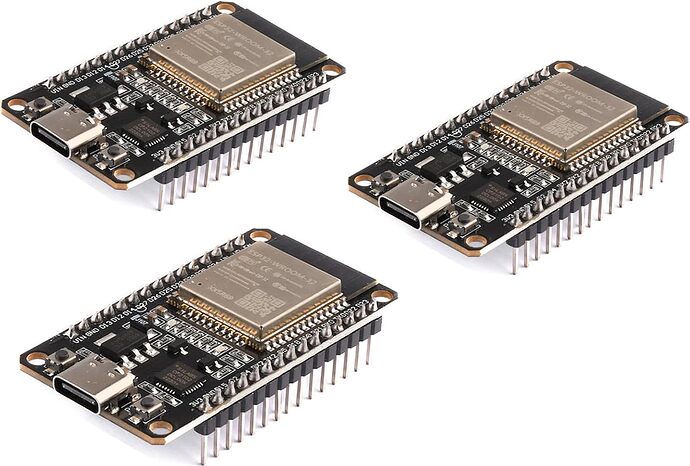

i just put in an other esp32. still the same.
Not the ESP the MAX31865 module
yeah i also switched out the cloned board (pink)to a brand new adafruit board (blue)

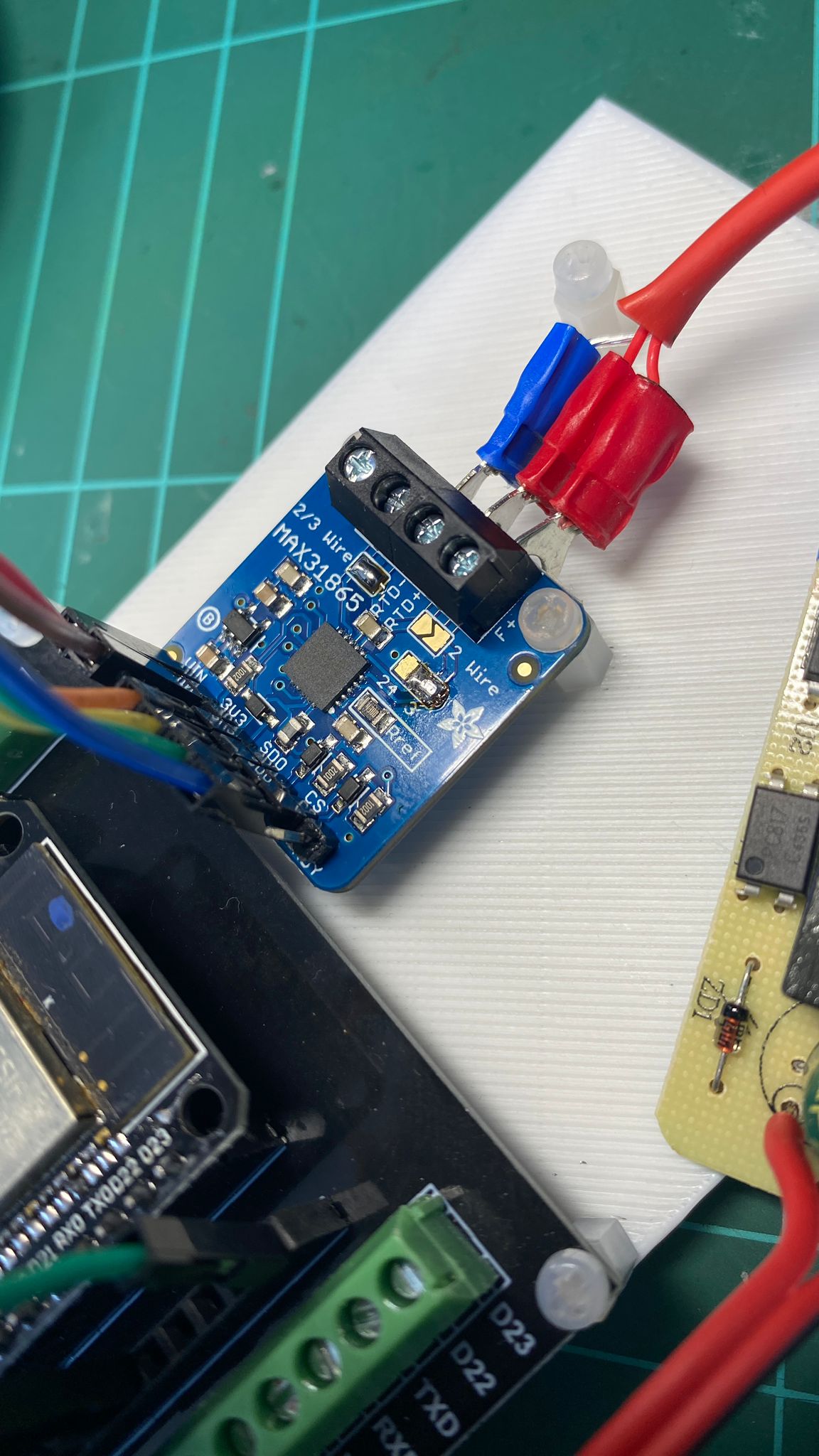

Could it be that i need pull up or pull down resistors betweeen the sdl and sda pins?
Grettings, Anabol

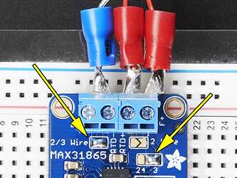

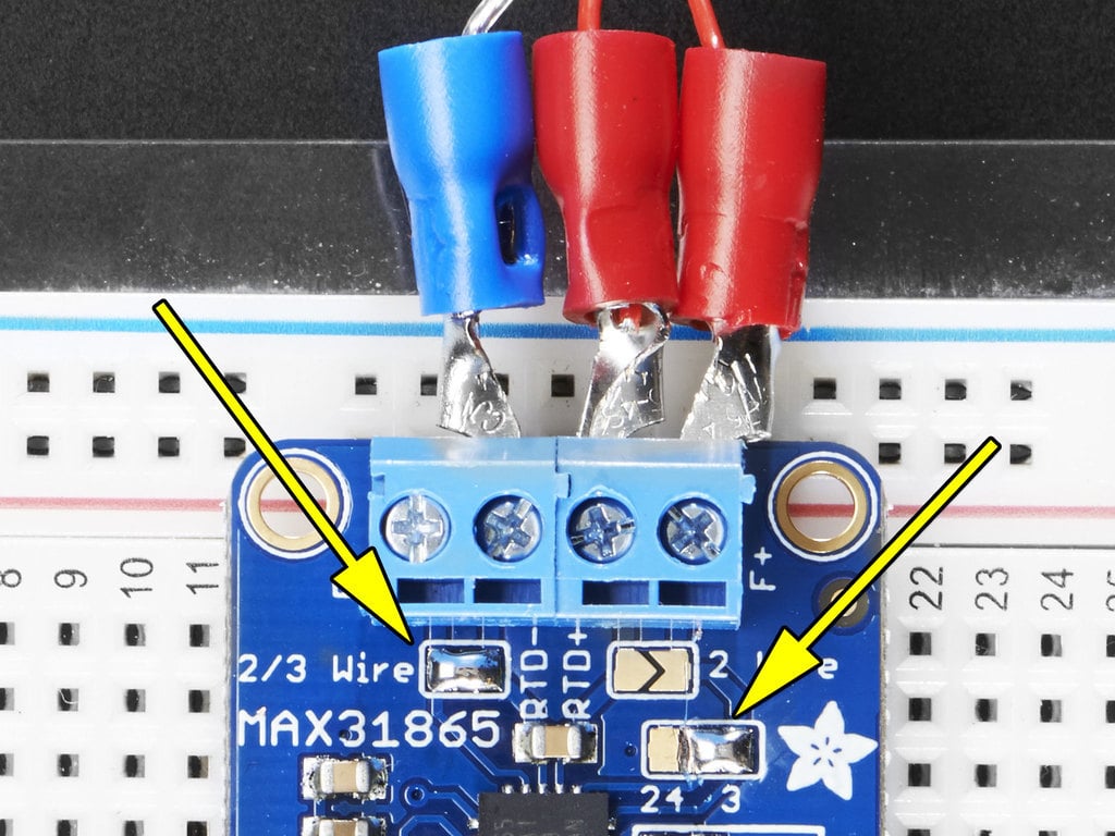

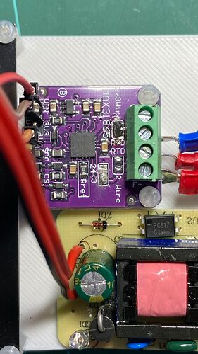

If I'm not mistaken, that blue wire at the far left should be at the far right.
Different wire colors but you get the idea.
And there may be a thin jumper between 2-4 on the right that you'll have to cut.
You have it wired wrong
Connect the three wires to the three right-most contacts. The ones with the same color are to the right. In your case the blue ones.
Did you get it to worK?
Don't know where you are looking but I see two BLUE wires.

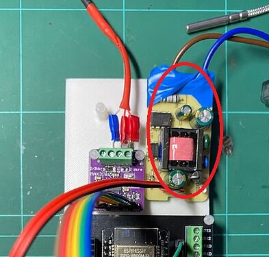

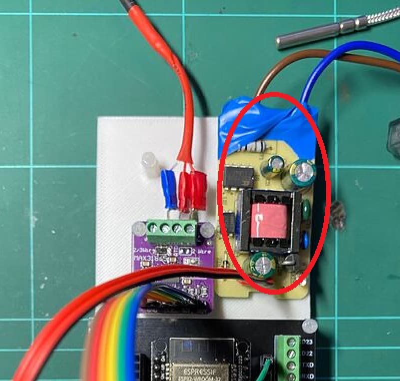

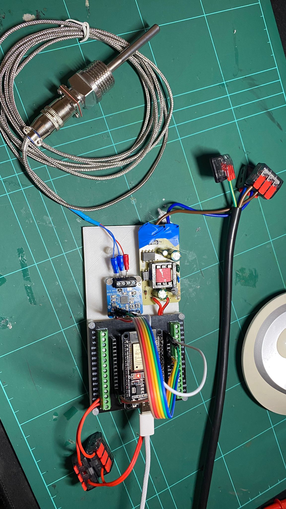

Can I suggest you get that AC Mains to DC power supply AWAY from the input module.
Bad placement, AC-DC converter is a switching device, emitting EMR, your 31865 is a low level input signal device.
Not a good combination so close together.
Also place a 0.1uF capacitor across a RED/BLUE pair of terminals on the input to the 31865.
