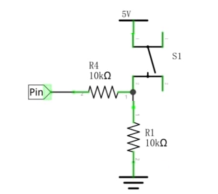

I have a FreeNove starter kit and running through the tutorials. On the attached image it shows the difference in a pull up and pull down circuit.
What I am confused about, is that on the two schematics shown, both appear to me to be schematically identical when the switches are closed, and yet one claims to read high and the other low.
Please can someone explain this?

What do the pins read when each switch is open ?
You are not confused, the second one makes no sense.
The first schematic is the correct way to detect button presses
The second schematic is wrong.
I've edited that second picture to show you what it should be like:
Pulldown Resistor Circuit - Modified

cobragra,
There is a link to download the documentation for that starter kit at https://freenove.com/tutorial.
If you download it from:
https://github.com/Freenove/Freenove_Starter_Kit/archive/master.zip
it looks as though the error has now been corrected.
(good job I checked before sending them an email).
