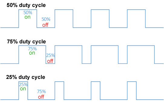

I think you need to do a pwm 101.
The voltage will not basically change, just switched on and off, the AVERAGE of the output will be a lower overall voltage.
So if on for 50% and off for 50%, the average will be 50% of the supply. The whole reason for pwm in mostly motor drives as it gives the load a repetitive set of pulses at 100% and thus maintaining torque.
The PWM is a way to digitally code an analog quantity between 0 and 100%.
