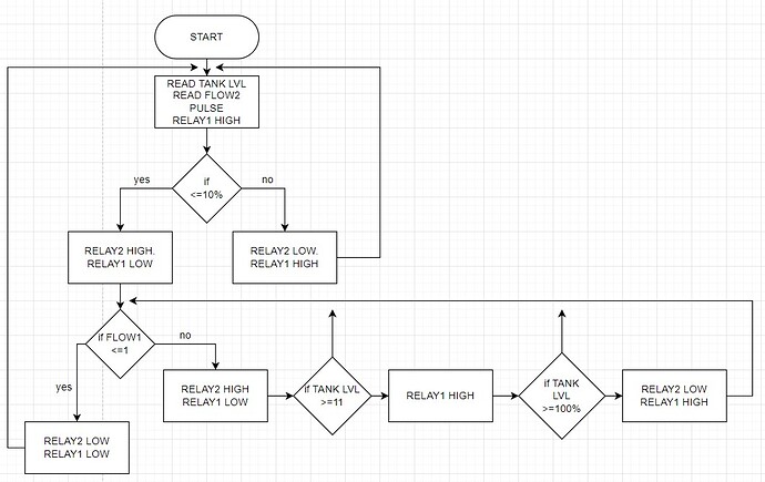

i build some system that can measure water tank level with ultrasonic and monitor water flow from 2 pump (in, out), 1 pump to fill in the tank, but must have to check weather is there water flow on pipe or not. then if no water flow in pipe then pump goes OFF after 5 minute then delay 5 minutes later pump should ON again still check the flow loop again, the second out pump only ON when tank level above 50%. if not pump 2 will OFF. all the 3 sensor and 2 relay display their activity on 2004 i2c LCD. water in liter/ minute, level tank in percent then relay in symbols.
Hello fachromiez
Post your sketch, well formated, with comments and in so called code tags "</>" and schematic to see how we can help.

may i correct, just learnd from copy paste.
i need to put some logic for Relay1
where Relay1 start for 5 minute if there any pulse from watermeterPinIn then Relay1 still ON, but when no pulse from watermeterPinIn after 5 minute Relay1 go OFF, then delay 5 minute. LOOP to start Relay1 ON again.. Without distrub main loop program.

Of course it will be easy to add the pomp automation to any loop function written in a non-blocking style.
I suggest you draw a flowchart, no language problem there, just a good old fashioned flow chart for the pomp.
You description is vague or ambiguous or incomplete. This is what I get:
  • turn on the pomp from some signal.
  • pomp stays on as long as signal is present
  • pomp pomp shits off after five minutes with no signal
  • when the pomp turns off, ignore for five minutes any signal that woukd turn it on again
Is the signal continuous while there is flow? Or is it a pulse at some frequency and duty cycle that correlates to flow?

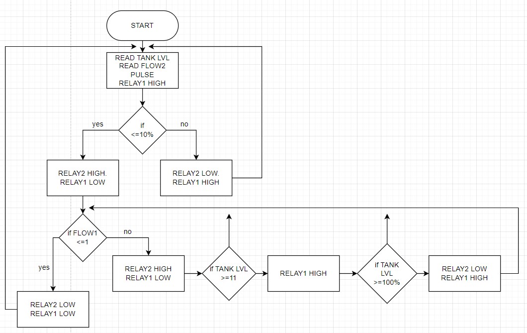

maybe like this.
Nice, but absolutely no mention of any 5 minute lock on wait for signal to disappear, or 5 minute lock out after the pomp stops.
Add that to your diagram, very pretty so far…
Also, did you ever say what relay 1 and relay 2 do?
Could you please describe the flow sensor, post a link to it. Tell us how it is used to develop the signal you are reacting to.
   if <= 10 %
Is that also referring to tank level?
