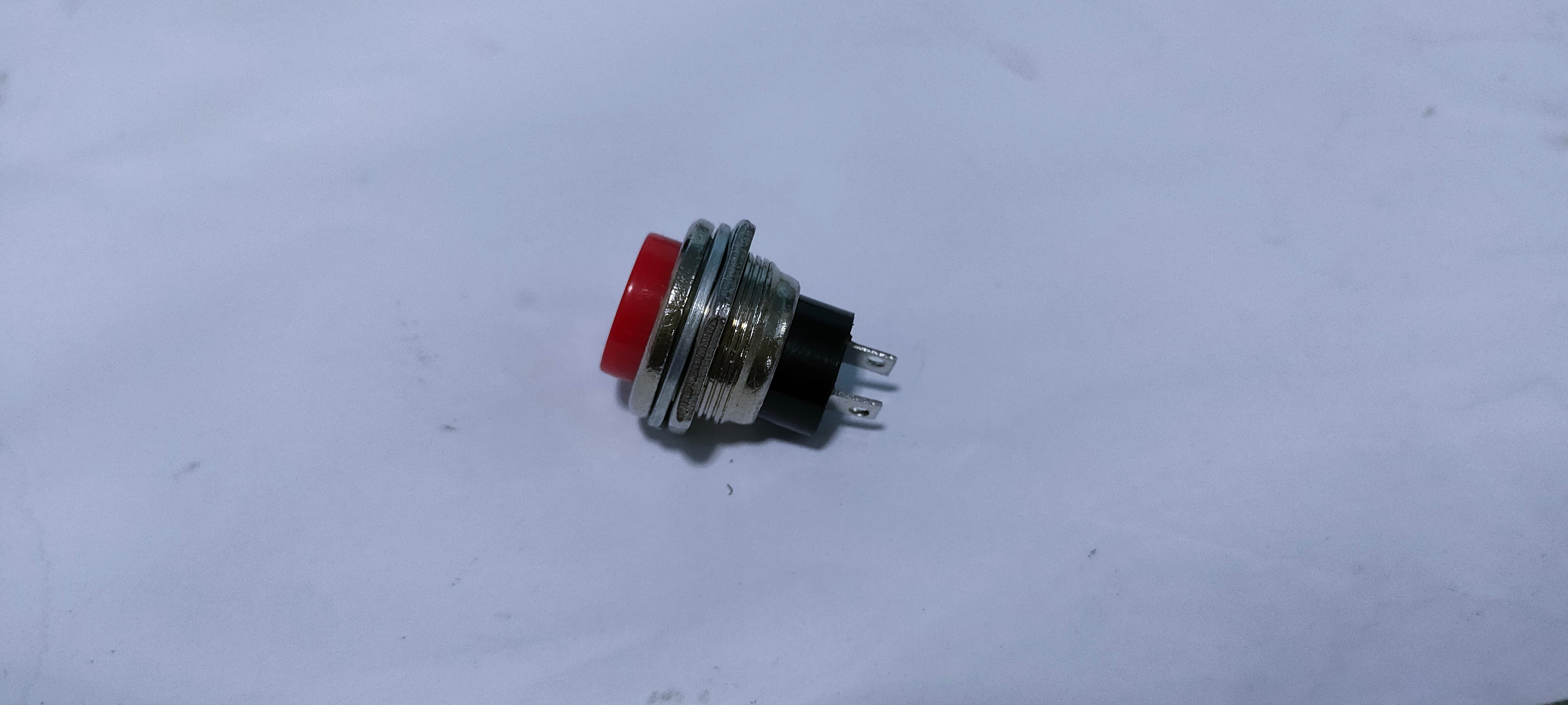

buttons are most commonly wired up with one leg connected to ground and the other leg connected to an arduino pin. Inside setup, you declare the pin as INPUT_PULLUP, which enabled a built-in pullup resistor for that pin. This means that if you are not pressing the button, you will read the pin as HIGH. If the button is pressed, the contacts will touch and the pin will be connected to ground so the pin will read as LOW.
In conjunction with @blh64's advice wire the switch as per S3 in the below drawing.
Arduino TypicalOutputs with warning
You will need to solder wires to the switch
Do you know how to solder?

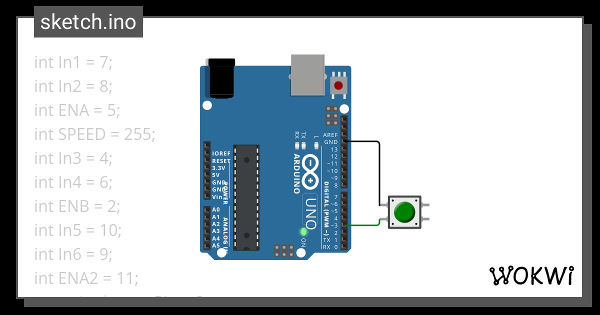

I've done wired the push button with the Arduino.
Now I need help for how to code it. As like I said in first place, I wanted to make a push button that when I push, the motors work in order for 1 round until end without holding the button. And when I press the button again it starts the motor order process again. So what are the functions and codes I need to do to make this work? Please give me some advices.

It seems like it's not working, I pressed the button but nothing happened. I tried checking wires, motors, nothing went wrong. I tried it with normal code with no button function and it works. I don't know what's wrong with it, maybe my codes are wrong or maybe my button wiring are incorrect.
I connect each leg of my momentary button with wire and connect it with bread board, then using jumpers wire to connect 1 leg to gnd and another leg to pin 3. I still don't understand what's wrong.

Post a schematic to see how the push button is connected.
If your button is wired correctly your initial code already works!
I added initialisation of the serial interface to your code and added letters and motor-numbers to the serial printing. Through the letters it is unique where your code is executing in the moment of the printing.
I left anything else as you coded it and it works.
You can test in in the WOKWI-simulator
If your code repeats one of this two reasons are likely cause the repeated execution
  1. You did not wire your button between ground and IO-pin 3
  2. you changed something in your code since you posted your code in post # 14
To find out what is really happening you should add serial printing to your code
Here is your code with:
  1. simplified button-checking
  2. non-blocking timing and but slowed down serial printing
best regards Stefan
