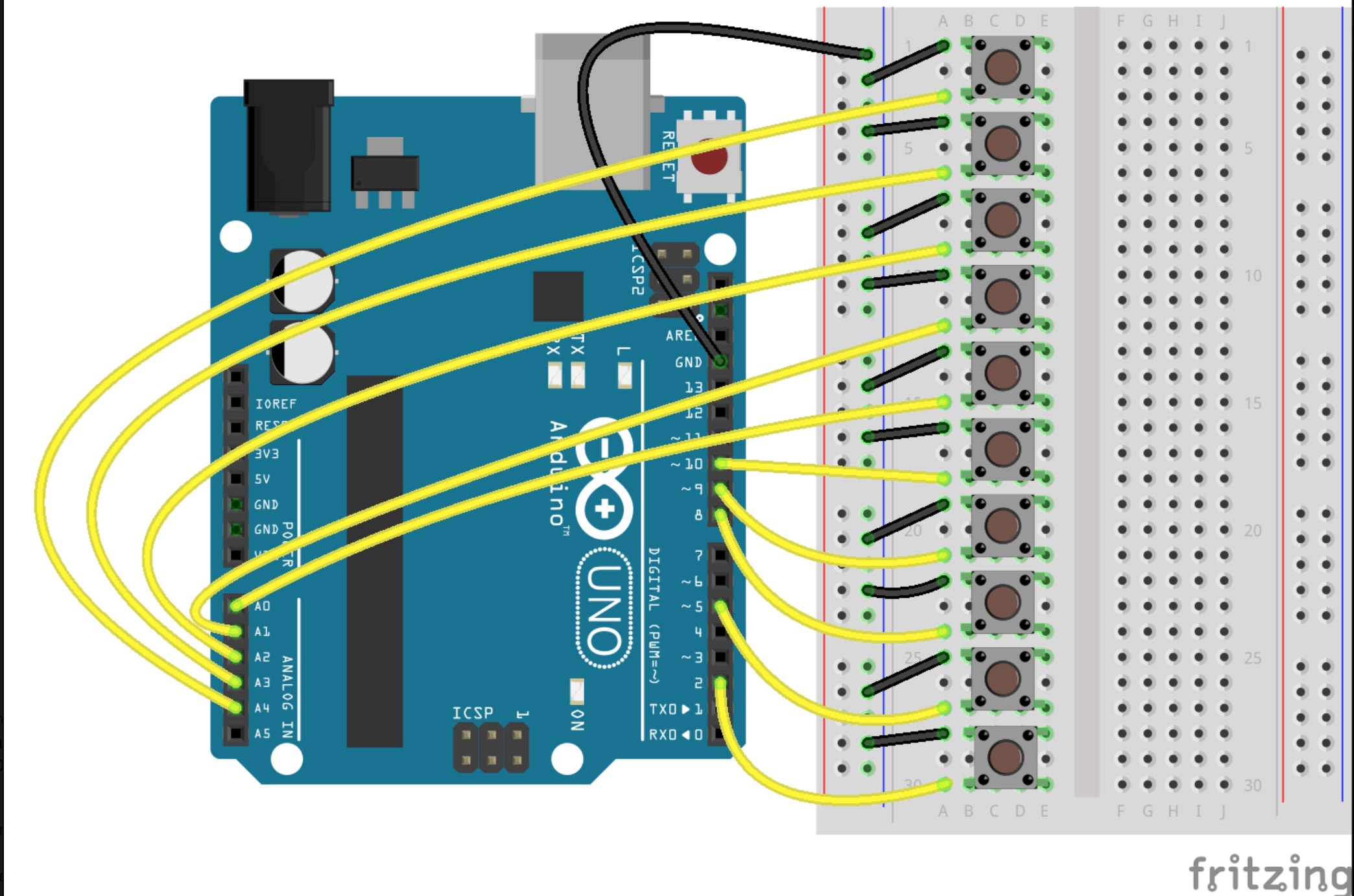

Hi everyone,
I'm working off a blog trying to build up my understanding of the Arduino in an attempt to build a pushbutton-controlled MP3 player for my toddler. This particular sketch features 10 buttons, but the sketch author failed to explain what it is supposed to do. If anyone has an idea by looking at the code, please let me know. I'm also including the fritzing schematic.
Thanks so much! :slight_smile:

It seems very well commented. Which part are you having trouble with?
The sketch prints some information about a button when that button becomes (goes from HIGH to LOW) pressed.
That is a general purpose counter sketch which records the number of times each button is pressed.
For your purpose, an MP3 player control, that is probably overkill but it does contain the classic elements of button debounce, watching state changes etc.
Presumably you'll be using a standard MP3 player module, maybe like this, and that dictates what buttons you require and their connections.
@CrossRoads, when I push the buttons, I don't see anything happening. So I'm trying to figure out what practical purpose does the sketch serve vis a vis the layout of the breadboard. Thanks.
OP's image
Show us a good image of your wiring.
You do have your serial monitor open and set to the right baud rate.
Hi everyone,
I'm attaching a picture of my breadboard. Also, when I open the serial monitor, I immediately get the following:

and then start pushing buttons one by one from bottom to top one by one, I get the following:

From what I can observe while I'm pushing the buttons, the first 4 buttons (at the bottom) give no response.
Thanks so much for your responses!
The power rails of your breadboard are split in the middle.
Jumper them.
