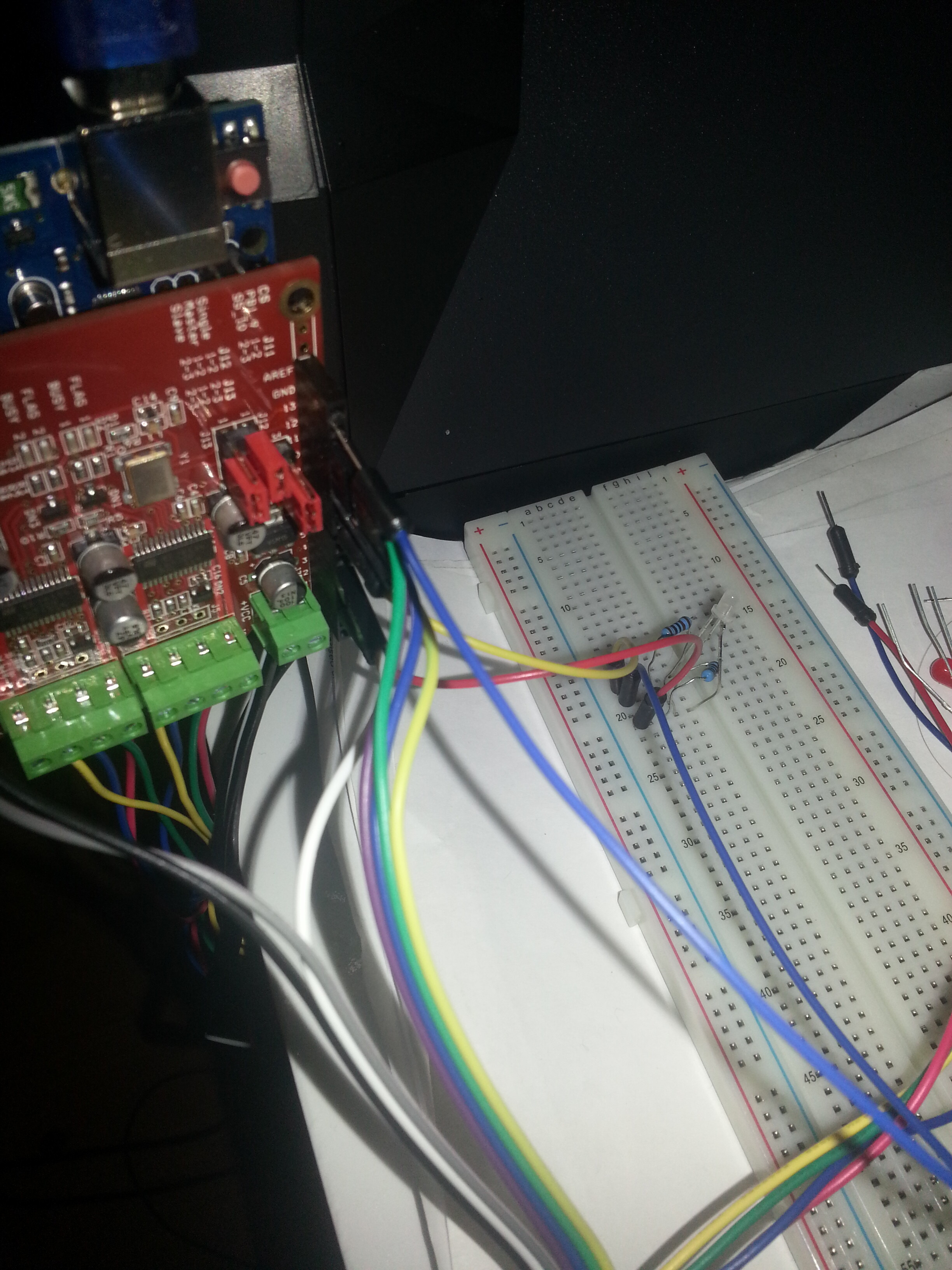

This should be something that's really simple to do but I'm not sure how to do it.
On my breadboard I have a multi coloured LED which displays in red and green. This LED is plugged in to two of the digital pins and ground.
I'm using an RFID reader which operates a couple of motors so when the RFID tag is placed over the reader the motors run and the LED glows red or green depending on which direction the motors move.
What I want to do is the same process as above but instead of using the RFID reader the push button is used. So there would be two ways of operating the motors, the push button and the RFID reader.
I've read a number of push button tutorials but so far I've not found anything that's helping me with this.
Anyone got any ideas how to connect up the push button? Or any links to a suitable tutorial would be good.
I've attached an image of what I've got so far.
This is the code I'm using to test it
int redPin = 2;
int greenPin = 8;
//int bluePin = 8;
int button = 1; // button pin
    pinMode(redPin, OUTPUT);
    pinMode(greenPin, OUTPUT);
   pinMode(button, INPUT); // button on pin 1
   int state = digitalRead(button);
    Serial.print(state);
    /* check if button is pressed */
    if (state == HIGH) {
        Serial.print("Green");
        setColor(0, 255, 0);     // Green
        Serial.print("Red");
        setColor(255, 0, 0);     // Red
       Serial.print("state is LOW");
void setColor(int red, int green, int blue)
    analogWrite(redPin, 255-red);
    analogWrite(greenPin, 255-green);
   // analogWrite(bluePin, 255-blue);

Change things a little:
int redPin = 2;
int greenPin = 8;
//int bluePin = 8;
int button = 1; // button pin   <<< Use a different pin, 0 & 1 are used by Serial
   pinMode(button, INPUT); // button on pin X << Change to INPUT_PULLUP for internal resistor
    if (state == LOW) {                     // Change to LOW - connect pin to GND when button is pushed
Hey,
Thank you very much, that certainly helped! I wasn't quite sure how to wire up the button but I've got it going now and the updated code did the trick.
This diagram helped me:
http://www.nudatech.com/blog/controlling-an-rgb-led-with-arduino/
As all the other tutorials | looked at just used a single colour LED that didn't help.
Thanks again
CaptainChainsaw :slight_smile:
