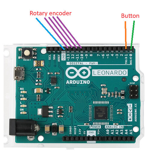

Push Button or rotary encoder(+GND) work with only digital pins ?
Everywhere I check guides i see examples of how to use Button or rotary encoders with Voltage. But I saw same youtube videos where they used only digital pins and GND for rotary.
Here is example is it possible? How code should look like in IDE and are resistors are needed for it ?
Very appreciated for your time, Chatgpt says it possible but their code is not working...
(EDIT: Rotary encoder connected like this rest to digital pins
My code is basically copy past and i do not know if sharing would help, if this is possible to set up it would be great if someone could put some example at least for button part. )

Which pins on the rotary encoder are those 5 wires connected to ?

added more info.

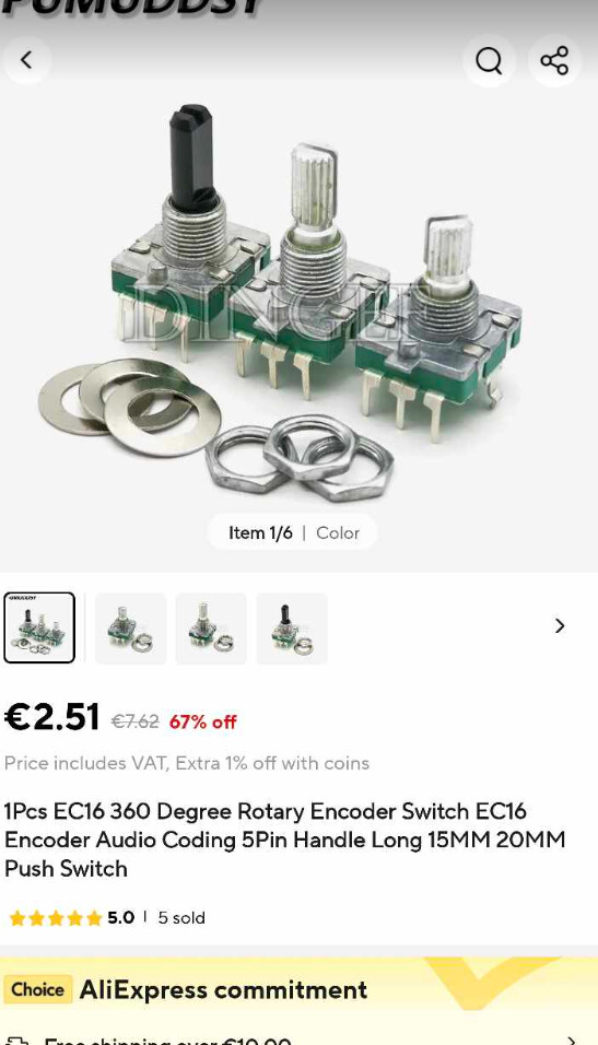

Please post an example of a guide where they read a rotary encoder with "voltage" (whatever that means). Are you sure that you're not confusing rotary encoders and potentiometers?
Like everywhere.
https://lastminuteengineers.com/rotary-encoder-arduino-tutorial/
A rotary encoder needs power; that's what Vcc is for.
And what you show in the second image in the opening post seems to be a potentiometer, not a rotary encoder.
it's rotary encoder, i bought from ali:
So rotary encoders do need Vcc always ? So my scheme is not correct and not possible right ?

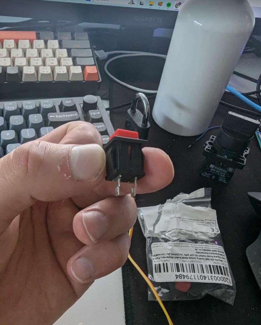

What about button like this:
Can it be connected to digital 1 and 2 without Vcc to work ?
Bsically this is the set-up
Slider works all fine, other two don't, do I need Voltage for them both or is it possible to set-up in IDE to work ?

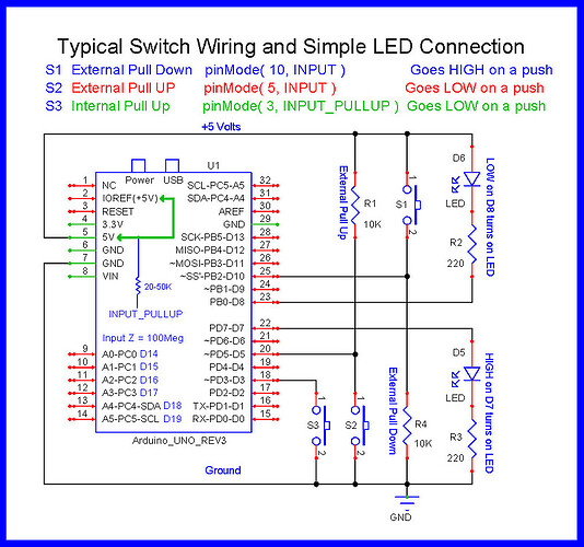

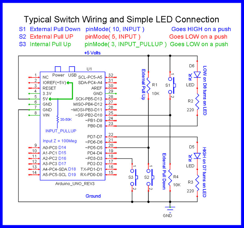

That can be connected as S3 in below image by @LarryD; use pinMode(yourPin, INPUT_PULLUP) in setup(). Or as S2 with an additional external pull-up resistor.
The same will apply to the switch in the rotary encoder; you can measure that with a multimeter.
Rather than connect the switch across 0 and 1 like in your diagram, select a different digital pin, for example, 8, and program it as an input with input pull-up. Then you can connect the encoder button switch between that pin and ground to sense when the button has been pressed.
Like in the post above that happened while I was typing.
I think i got it. I had to set one pin to output other to pullup. Not it works for the button.

Okay, but then why when there are examples with one button ground is connected physically via pin and it's needed but when there are button matrix there is no ground connected and everything works fine?
In some keypad scan configurations, an output pin is used as a pseudo ground when it is set LOW, it is part of the scanning scheme, but why waste 2 digital pins for a single button.
If you have 5 pushbuttons then you would need 10 pins
I am just trying to understand step by step because in future I am planning to set up bunch of buttons. How does that pseudo ground is being set up? Is it in IDE maybe you have example with one button without those array lists? They confuse even more.

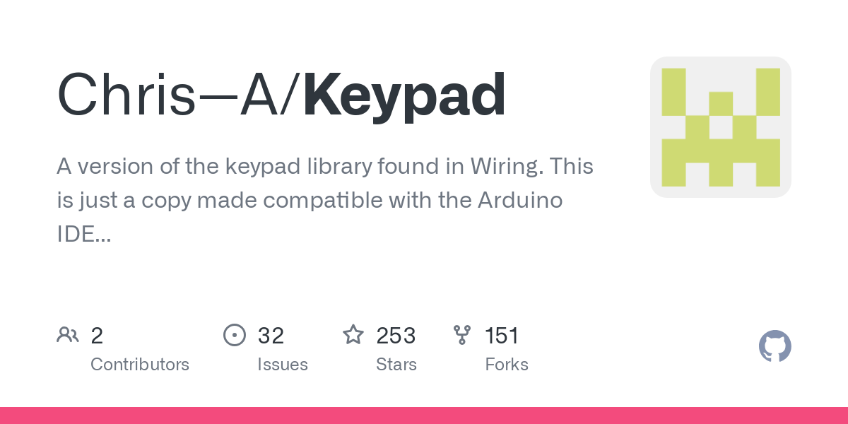

There are plenty of examples on the internet on how to use a button array/keypad with an arduino.
This one for instance:
These guides shows blindly how to do it without understanding or deconstructing the process. What is happening under keypad library is unknow for me therefore it does not help to understand the process.
Well you can examine the code for the library or any library you use.
