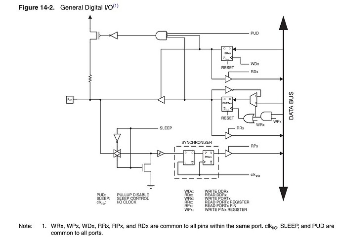

Yes. The internal pullups are about 20Kohm, so they don't supply much power. That's good, though, as such limited power generally doesn't fry things when mistakes are made.
If so, how does the input pin behave when one leg of the pushbutton is connected to 5V instead?
Nothing happens, I believe. It should still read HIGH just as it did with the button unpressed. But I'll defer to someone with more experience...
The "pull-up" is a transistor (FET) within the chip which - when you enable it in the software - feeds a current (if the pin is externally pulled low) from Vcc to the input pin, as if you had connected your 10K resistor between Vcc and the input pin.
If you connect the pushbutton to Vcc instead with no external resistor, well, the pull-up will be pulling the pin high and your pushbutton will be doing the same, so no difference whether the button is pushed or not.
As previously mentioned, if you have neither an external resistor, or the pull-up enabled, then unless the button is pressed, the voltage on the input pin will be quite random and - if your wires are reasonably long - will probably detect the electrostatic field radiated from all the mains wiring in the room and fluctuate high and low. (The internal clamp diodes in the chip, on which you should never rely, will restrict the pin voltage between ground and Vcc.)
For a slightly more complex, if not confusing, explaination....
Here's what the "inside" of the pin looks like in schematic form.
