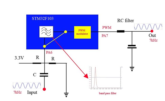

PWM basic. How to ?
There must be a simple code for this circuit - sine in sine out. Any solution welcome.
(deleted)
I tried, the problem is in default PWM frequency of stm32 board = 550Hz, as a result of that when I apply 7kHz modulating frequency is not a signal frequency but 5Hz. So after fitering the output will be 5Hz not 7kHz, will be because I dont have 5Hz RC filter. I think I need to use one of the stm32 timers = no idea haw to to that.

He wants to implement a digital filter on the STM32. Read analog input, filter, output as PWM, filter out PWM frequency.
For a 7 kHz signal you need a sample rate of at least 15 kHz (if you can minimize any noise > 7.5 kHz using an analog filter on the input). Let's assume that you can do that.
The next thing you have to check is if your filter code runs fast enough. You've only got 66 microseconds to sample, calculate and output.
That shouldn't be a problem if you're using low order filters. Implement your filter code in the loop, let it run freely, and check how long it takes.
You can speed up the sampling process by manipulating the ADC registers directly: read sample, start conversion, filter, output, repeat.
Instead of using analogRead: start conversion, wait for conversion to finish (wasted time), read sample, filter, output, repeat.
Or put it in free running mode, as suggested.
The next problem is getting the PWM frequency high enough. This is necessary, because you have to filter out this frequency in hardware, without filtering out the 7 kHz signal. Depending on the type of filter (RC or LC) you'll get a slope of -20dB/dec or -40dB/dec for your analog filter. You'll probably want to use an LC filter (or a second order filter) and a frequency of one decade higher than 7 kHz for approximately 40 dB of attenuation of the PWM frequency. (This depends on your needs, of course.)
That's 70 kHz, which is pretty high. Check the STM32's data sheet for information on how to set up the timers to output PWM at that frequency.
You'll probably want to put the sampling and filtering in a timer interrupt as well.
The question is: is all that really worth the effort?

I am using stm32f103 and LC filter. The LC filter is not a issue, it is working very good.
ted:
That doesn't say anything. What values are you using? Is it a simple LC low-pass? Your circuit in #2 shows an RC low-pass.

RC is on the drawing for simplicity (mostly used ) it is working not bad 10k/10nf , something like that - I used it long time ago, I have replaced R by L 10mH and C by 47nf, output - nice 20V sine wave.

So far I have sine wave generator 7kHz with timer setup for this frequency, sampling rate 700 kHz, so the PWM output frequency is ok. PWM on PB7 is modulated by sine generator, what is need is disabling the generator and modulate the PWM by signal applyed to PB0 .

Please look at post #1, 5 Hz is a side effect of my attempts. Currently I am working on post #14, on the drawing you can see my goal, fot now I am using a teporary yellow jumper.

STM32F103 is working at 72MHz, post # 14 is a 7kHz sine generator with PWM frequency 700 kHz , so I need to change the input of the modulator. Now modulation is from from sine generator and I need modulate PWM by signal applyed to PA6.
