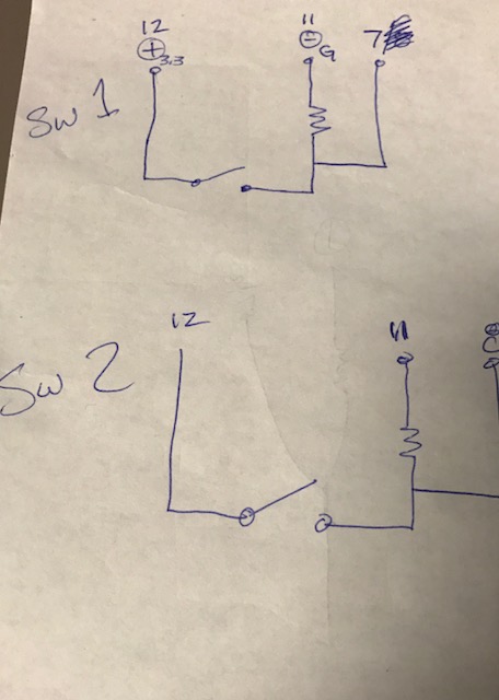

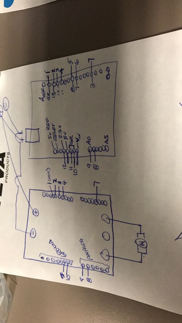

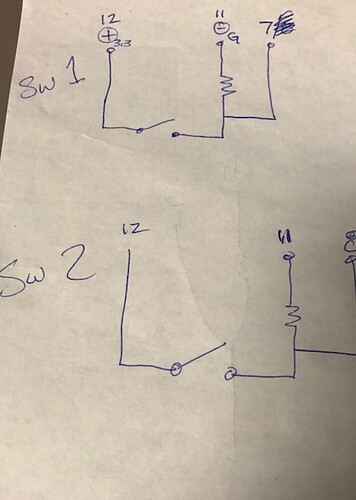

I am very new to electronics and working on a code for a work project. I need to add PWM to my code to control both the duty cycle and frequency. I need it ran in the 10kHz range. Currently the code contains two push buttons that control the motor's direction. (One button for forward and one for reverse). The motor is normally off and then activated by the use of the push buttons. I do not have great code tags because I am not sure I thoroughly understand the code. I do not have a very technical background so please try to keep things simple. Thanks. I copied and pasted the code as well as attached it.

Attached are the schematics I was provided with for the Arduino and shield. And also the manual for the shield.
Your code already has PWM commands in it.
analogWrite are PWM output commands.
Tom... :slight_smile:
Further reading: PWM tutorial
