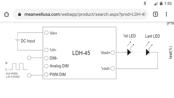

I have been looking into using an Arduino Uno Rev3 to supply supply a PWM signal to 3, possibly 4 LED drivers.
The research I've done indicates that most Arduino clocks run under 1khz, however the drivers are suggested to receive a signal between 1khz and 10khz.
I uncovered an old thread using the same MeanWell drivers I am that had some bad advice (according to the drivers documents) regarding grounding the PWM circuit. That thread did indicate that the frequency can be manipulated using code, but given that the person seeking help kept burning out pins after following the advice given, and the thread came to a dead end, I'm not sure what to believe.
And this thread is where?
The problem is that the PWM control input is (presumably) not isolated from the rest of the circuit.

My apologies, I should have indicated right at the start that I discovered Arduino and the like about 3 weeks ago. So I appreciate some patience. I'm unfamiliar with its capabilities, however, electricity and I have a 30 year relationship.
All I would like to accomplish is to have different spectrums come on at different times, utilizing the same clock. (Without burning my house down) I'll probably just use the available relays, if I even use this platform.
Through the sarcasm I did manage to get some information, for that, I thank you Paul.
Here is a link to the previously mentioned thread.
https://forum.arduino.cc/index.php?topic=119825.0

Hello Wawa,
The LDH-45 were the available MeanWell boost drivers available where I was shopping.
The data sheet for the driver indicates the PWM signal should be between 1khz and 10khz, I'm not sure if that is a problem or not, but it seems to me like it might be.

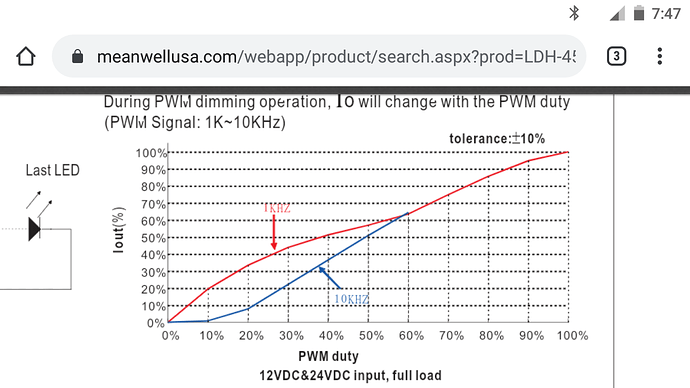

No experience with that driver. PWM frequency only seems to affect linearity in the low-light region.
Don't know if you're expecting dimming to low light levels.
That might not be possible with higher PWM frequencies.
Can try PWM pin 5 and/or 6 (Uno). They default to 1kHz.
Leo..
Thank you Leo,
It appears that the driver has a broader range of brightness at 1kHz versus 10kHz, so pins 5 and 6 should be ideal. I wasn't sure if 980Hz was close enough, I do know in many industries its common practice to round up, but I didn't want to assume.
