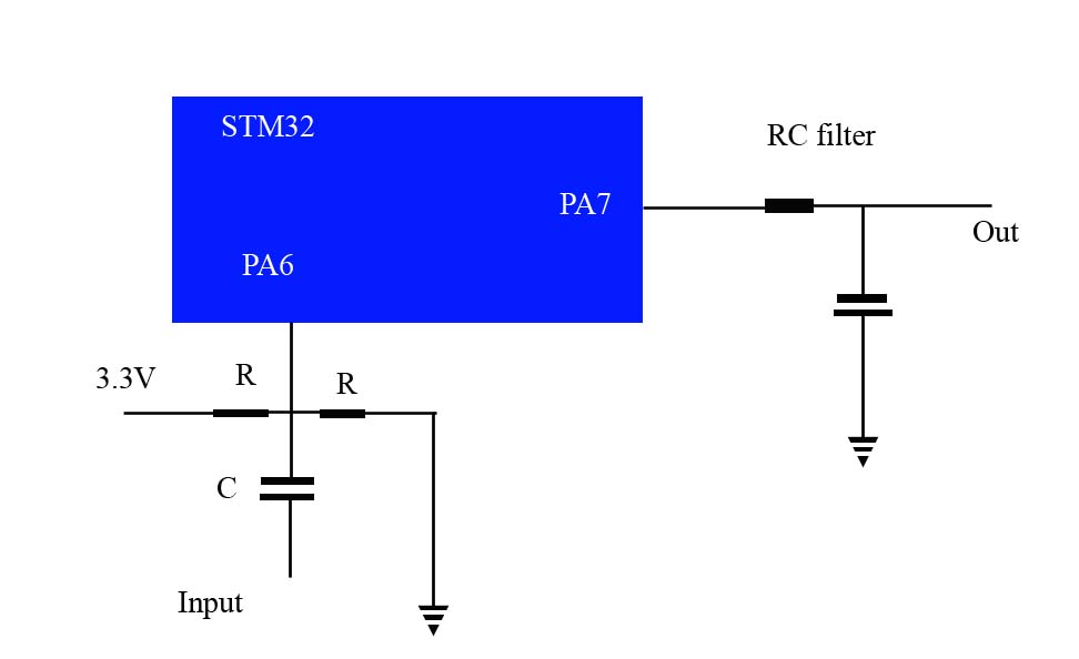

How you put my drawing in the post ?
When I click - insert picture - there is only option for link, so I used attachment option.

In signal serial plotter the signal is ok
When I compare PWM from sine generator with smoothing filter PWM they different,
the first one is blurred the second one is a clear square wave with visible with modulation.
In serial plotter the signal is ok

PWM from sine generator... what do you mean?
A PWM modulated by the sinewave is what you get, do you want a sinewave output.
The reason your monitor waveform is sinusoidal is because you are reading the dutycycle value of your filter, the duty cycle being modulated by your sinewave input.
You can try and use a LP filter on the output to get your PWM to convert to analog sinewave.
I have two programs and I am comparing the shape of PWM of both.
I have this filter
For sine wave generator frequency of PWM pulses is 100 times higher then frequency of sine wave, in smoothing program is 550 Hz, dividing it by 100 =5.5Hz, so this program is ok for very low frequences - rotating speed of the potentiometer.
Okay I think I understand.
You are feeding your noisy analog signal into the controller and using smoothing aiming to get rid of the noise.
You are happy with the sinewave modulated PWM output.
You are comparing this sinewave modulated output with a signal generator produced sinewave modulated PWM.
How are you synchronizing your scope?
Are your PWM frequencies the same?
Is the noisy sinewave in phase with the sinewave you are modulating the the sig gen PWM with?
Are you synching the scope to the analog sinewave?
If your scope sync is not right, one channel will always appear to have blurring duty cycle.
Tom.... :slight_smile:
Frequences -Look post #50, correction for that 1000 not 100.
Ohh great, you have a proper CRO.. Yes.. :slight_smile: :slight_smile: :slight_smile:
But image on left screen lower line is different than on serial plotter - post #47, as far I now arduino default frequency is 450 Hz or 550Hz, so I need to change it some how.

And what is it you're trying to do? From what I understand, you want to read a noisy sine wave input denoise it using digital filters, then modulate it as PWM, and use an analog low-pass filter to filter out the PWM frequency again. Is that correct?
Pieter
Hi Pieter
Thanks for reply
I am interested in digital filters to see what they can do in practice, to compare them with Switched Capacitor Filters (max7400, MSFS 5). I generate the code for filter using
https://www-users.cs.york.ac.uk/~fisher/mkfilter/trad.html .
I am jus trying to figure out how to implement generated code, to have input and output of the filter on pins of stm32.
