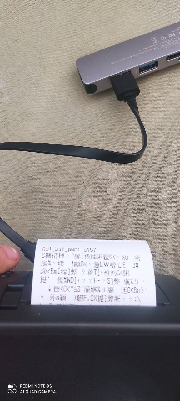

I'm using this code to print some text with esp8266, but the printer is not printer the right text.
I've attached some img of the result

Your topic was MOVED to its current forum category which is more appropriate than the original as it has nothing to do with Installation and Troubleshooting of the IDE

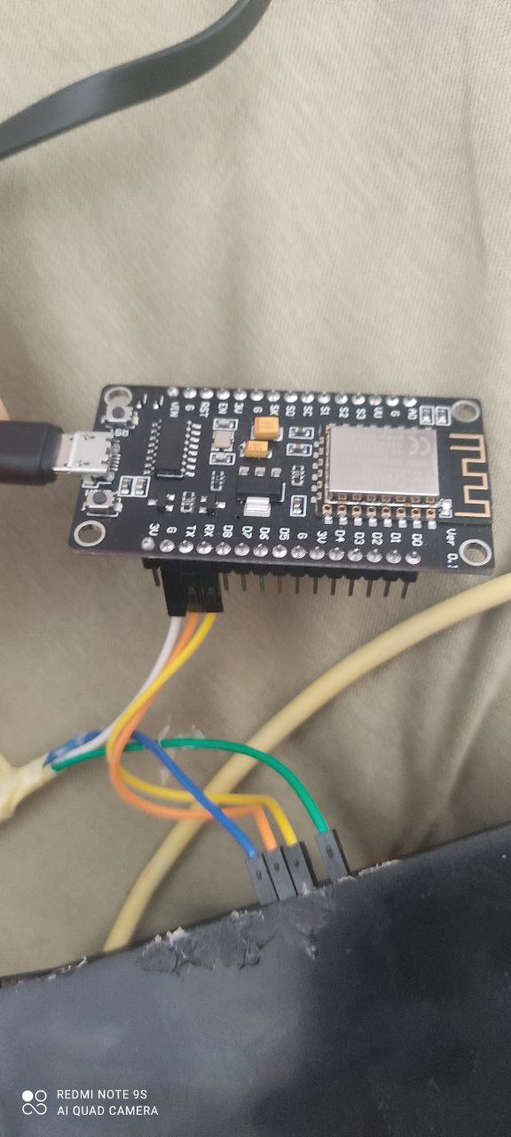

Do you have a GND connection from your printer to esp?
the GND connection is from the power supply, and the esp takes power from the usb connection as it shown in the img
So you don't? Also, is the printer a 5V logic or 3.3V logic output?
yes I don't, and I use 5V power supply for the printer
As already mentioned, you need a common GND between the ESP and the printer.
What does your printer datasheet say about the serial interface voltage levels?
What software was running when the printer printed "hellohello"?
I made GND between the ESP and the printer, and getting the same result, I've attached photos of the result.

thanks for you guys I found the solution I should select the correct board on the IDE the nodemcu and this code was working fine for me.
