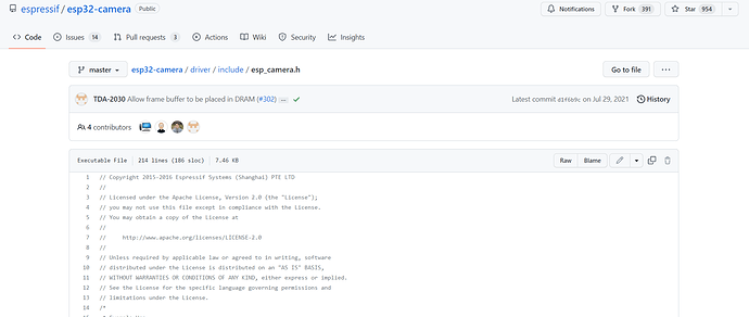

The example sketch of ESP camera: CameraWebServer_Access_Point.
got error of 'esp_camera.h' No such file or direction , online searched out:
esp32-camera/esp_camera.h at master · espressif/esp32-camera · GitHub
download as : GitHub - espressif/esp32-camera
and Sketch - include Library and got error: Specified folder/zip file does not contain a valid library.
why?
thanks
ADAM

ERROR:
Arduino: 1.8.19 (Windows 10), Board: "Arduino Mega or Mega 2560, ATmega2560 (Mega 2560)"
CameraWebServer_Access_Point:9:10: fatal error: esp_camera.h: No such file or directory
 #include "esp_camera.h"
compilation terminated.
exit status 1
Invalid library found in C:\Users\Xinzhou\Documents\Arduino\libraries\WiFiEsp-master: no headers files (.h) found in C:\Users\Xinzhou\Documents\Arduino\libraries\WiFiEsp-master
This report would have more information with
"Show verbose output during compilation"
option enabled in File -> Preferences.
Wild guess here. Perhaps you should try compiling for an ESP32-based board rather than an Arduino Mega.
Thank you .
Ya, I forget to change it back.
