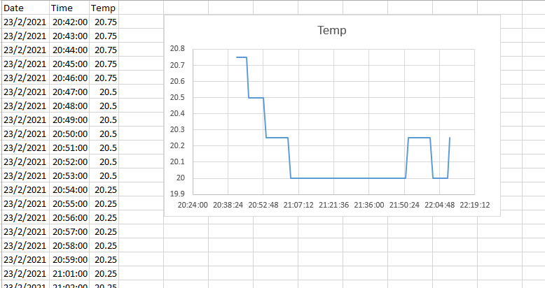

Let us follow every step of this tutorial. When a step is done, then put a tick mark on it. After the expected result has been achieved, we may slowly study the functions of the codes lines of the sketch.
1. Connect DS3231 Module as per diagram of Fig-1.
Figure-1:
2. Upload the following sketch.

2. Observe that the Serial Monitor shows the current date, time in 24-Hrs format, and temperature at 1-min interval (Fig-2). The current date and time are taken from PC; however, the user can (if he wishes) set it manually in the setup() function of the sketch by manipulating the following codes:
rtc.adjust(DateTime(F(__DATE__), F(__TIME__))); //takes data time from PC
  //rtc.adjust(DateTime(2021, 12, 31, 11, 59, 57));//set date-time manualy:yr,mo,dy,hr,mn,sec
Figure-2:

**2.** Observe that the Serial Monitor shows the current date, time in 24-Hrs format, and temperature at 1-min interval (Fig-2). The current date and time are taken from PC; however, the user can (if he wishes) set it manually in the setup() function of the sketch by manipulating the following codes: -DONE
rtc.adjust(DateTime(F(DATE), F(TIME))); //takes data time from PC
![SMq12.png|605x448](upload://qkePspfvvV71EKGmKMsA2VwD8Vo.png)
Figure-2:

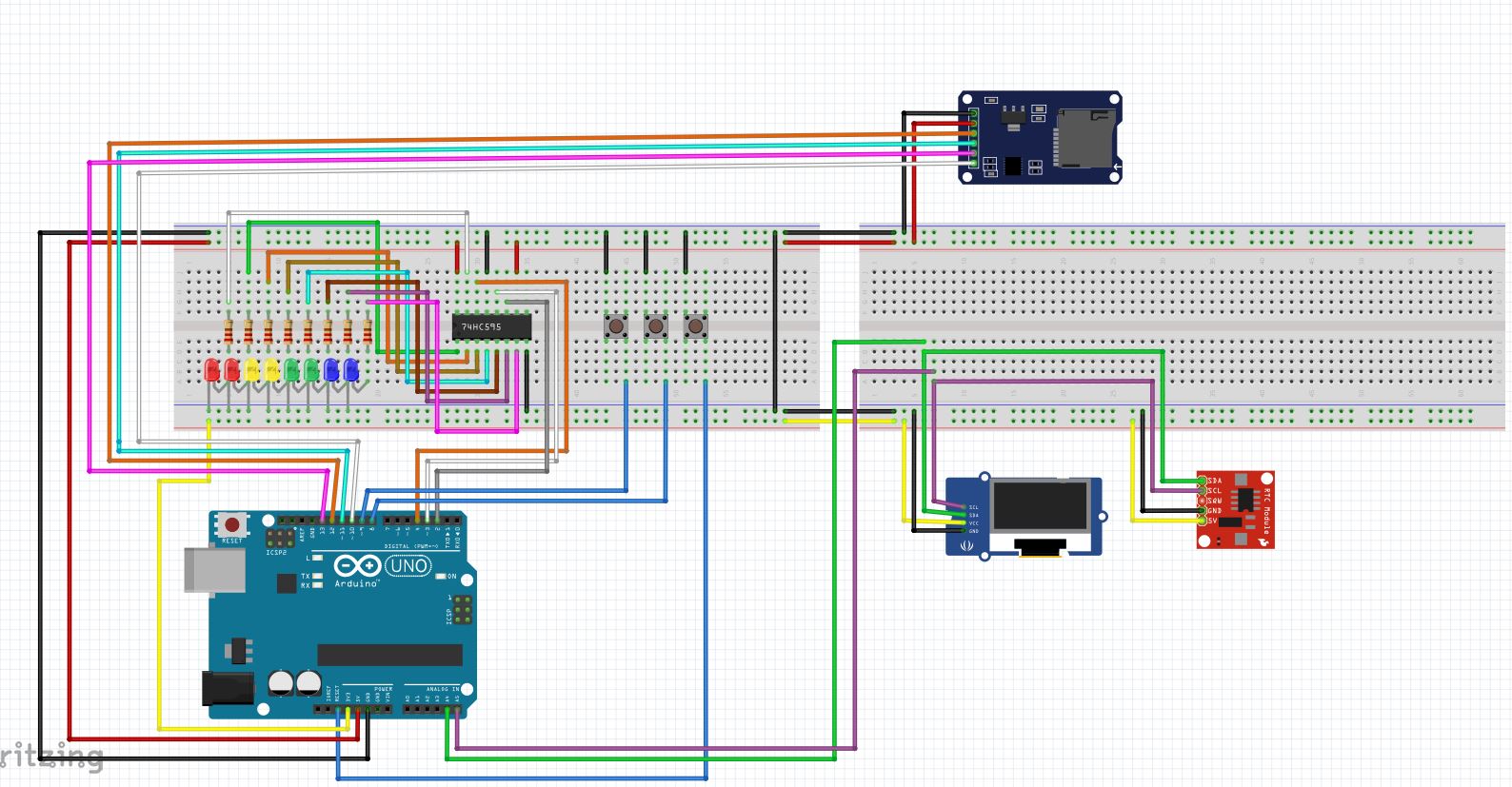

Thank you for your support, both of these items perform as described.
I have attached a layout of the hardware I am using and how it is currently wired in system. A few items that were left out of the original description can be found below. I want to define this hear so it is clear what we are working with.
Hardware:
1: UNO/NANO
2: 0.96" OLED screen 3.3V (adafruit GFX library)
3: DS3231RTC module 3.3V
4: 74HC595 Shift Register
5: 8x LED
6: Button 1 - sets RTC segment adjust
7: Button 2 - RTC increment
8: Button 3 - RESET
At the moment, there is no hardware provision for a "store" button, but I like the concept and it could likely be packaged.

Why do you power the OLED and the DS3231 with 3.3V ?
Can you give a link to your modules ? A link to where you bought it.
A SD memory card runs at 3.3V, so there should be a chip on the SD module to translate the 5V signals from the Arduino Uno.
A OLED runs at 3.3V, regardless what sellers claim. Only Adafruit has made their OLED displays compatible with 5V boards.
The DS3231 runs at 3.3V and at 5V, unless it is a cheap module, then the battery gets overcharged.
I am not sure that I understand your post. You ask why I am powering the oled with 3.3V then you state that almost all oleds run on 3.3V... I am using a WayinTop kit i ordered off of amazon that comes with the DS3231, OLED, & SD module. Their tutorial shows the connections for oled and DS3231 as 3.3V connections. There are no markings on the hardware that define a third party manufacturer.
sgmedi:
I sure did !
The OLED has a voltage regulator, but regardless if you power it with 5V or with 3.3V, the I2C bus of the OLED is for 3.3V signals.
Those OLED displays are known to disturb the I2C bus for others.
This kit ? https://www.amazon.com/WayinTop-Tutorial-Arduino-Development-Breadboard/dp/B082X9MGYR/.
If you power the RTC module with 3.3V, then it has 3.3V signal on the I2C bus. That is low. However, if you power it with 5V then the battery gets overcharged.
Your SD card module has level shifters. That is okay. It works with 3.3V and 5V Arduino boards.
This is a good OLED module, that works with 3.3V and 5V Arduino boards: Monochrome 128x32 I2C OLED graphic display : ID 931 : $17.50 : Adafruit Industries, Unique & fun DIY electronics and kits.
This is a good RTC module that works with 3.3V and 5V Arduino boards: Adafruit DS3231 Precision RTC Breakout : ID 3013 : $17.50 : Adafruit Industries, Unique & fun DIY electronics and kits.
You get what you paid for.
Koepel:
Now I understand your question. Based on the tutorial for the kit (the one you linked), the RTC has a level shift as well. I have not been able to confirm this, but the system itself works when powered as is.
Few Remarks:
1. As per data sheets, the DS3231 chip could be operated at a supply voltage of: 2.2V (min) - 3.3V(typ) - 5.5V (max). Should we operate it with Arduino UNO with 3.3V supply voltage?
The answer is "No"; because, the minimum VOH value of UNO is 4.2V; whereas, the maximum VIH of DS3231 is 3.6V (Vcc + 0.3V = 3.6V). Here, we observe a clear violation of electrical specification.
2. SD Card is a 3.3V device; however, it can be operated at 5V supply voltage as the card driver contains necessary 5V/3.3V regulator and level sifter. It will also work on 3.3V supply voltage which directly gets connected with the output pin of the voltage regulator.

Here is the latest attempt at coding the RTC storage and prepping the rest. The OLED, shift register, etc currently are not implemented. I can get the RTC data over serial monitor no problem that works like a charm. I can't seem to get the SD Card. I have verified all connections but it seems like i may have missed something in the code. Any suggestions on where I should be looking?
Look for the bold text here: SD - Arduino Reference.
Your pin 10 must be an output.
Good follower and I offer you +; however, you have redundant codes in your sketch that could be optimized later on.
Have you verified that the SD Card works alone? How do you know that SD Card is not recording data?
To have a control on what you are doing, you are advised to install a "Start Recording Button" and a "Stop Recording Button".
When Stop button will be pressed, there will be no more recording on the SD Card and the recorded data of the SD card would be dumped on Serial Monitor. This is the way that I follow to verify that data have been really written onto SD Card.
Best luck!
First log is successful! Seems to that my mistake was using D10 as an input for a switch.
Now to try and integrate the rest of the hardware....
