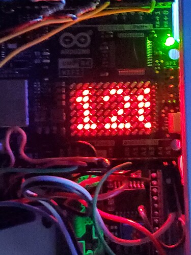

I am sending a number string (pulse count) to the LED matrix (ie:123) but it is shifted to the right by 2 led columns, so the last character gets cut off. is there a way to shift it over 2 columns? It can also scroll, but I prefer it to be stationary.

You are using a 5x7 font on a display that is 12 columns wide, you will not be able to display three characters at once, so scrolling will be necessary.
This is what I expected. (Scrolling solution)

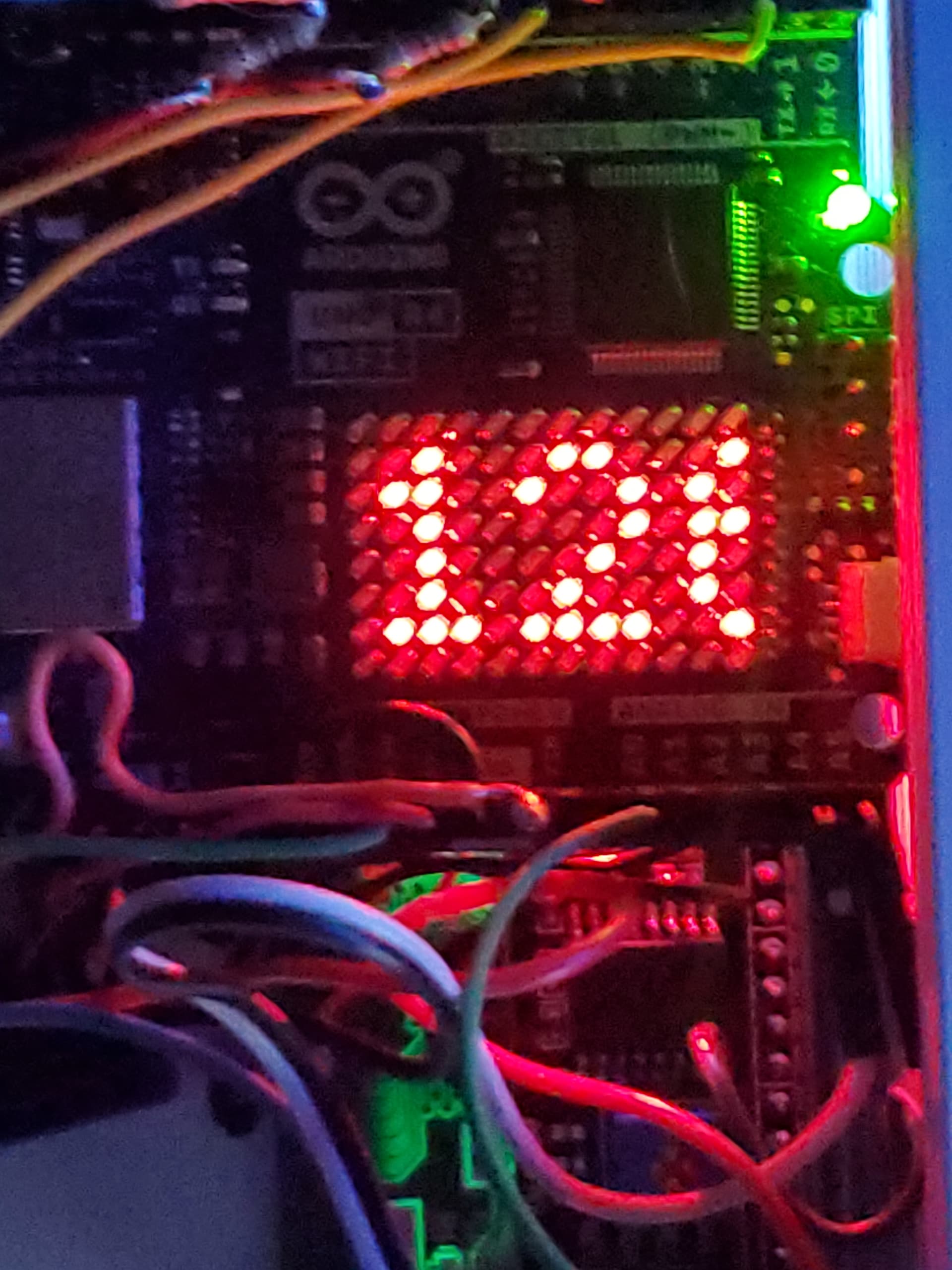

But do not understand why the first column is blank, when the 3rd character fills the last two columns and is cut off. It displays 2 1/2 characters. The text is not centered in the matrix. I tried a 4 x 6 font and it displays all 3 characters so long as the first is a 1.
Even a two number string is not centered, but left justified. Not a big deal, is there a way to center justify?
Am guessing the random justification is just a quirk with the LED matrix?

Switching to a smaller 4 x 6 font solved my immediate problem.
