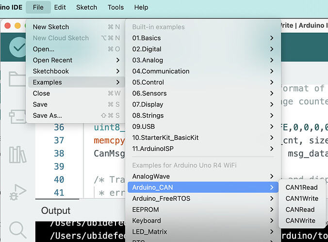

Also very useful are the examples appearing once you select the correct board

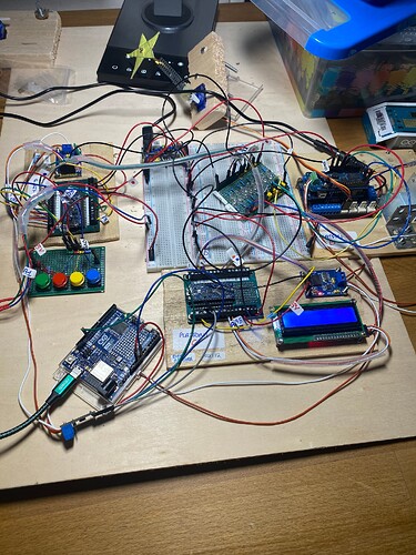

And just for a bit of fun, in the context :slight_smile: it's 11 pm here in Milan after all... here a picture of the new Arduino R4 joining the other Arduinos brothers on the canbus workbench :slight_smile:
the comet star in the picture is also suggesting that the idea is to use canbus as the "nervous system" of the upcoming Christmas nativity scene smart blocks :slight_smile: :slight_smile:

here below canbus logical model architecture:
As you can see, with Arduino R4 Wifi I'm using SN65HVD230 as CAN Board which is powered @ 3.3 volt and therefore I'm not facing level shifter issues. In my past experience switching for canbus board from 3,3 to 5 volt has always been a nightmare and therefore I got rid of this problem by selecting a board that can be powered @3.3 without issues
