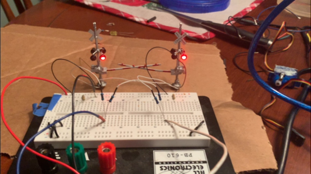

Railroad grade crossing project
Please see photo. I am about to dive into this project. It will have IR sensors, flashing LEDs, and servos for the gates.
I am a little intimidated about incorporating all these in one program. I am afraid of state machines. Any advice on a simplistic form of detection on the track?
I was thinking of just getting everything operating in a manual mode first.
Thanks!
Kennedy

In the code you posted I pointed where I think the mistake lies (I put the comment in the above quote). :wink:
Hope that helps....
They both come on then alternate once. Then resumes flashing pin 13 only.
if (ledState12 == HIGH) {
ledState12 = LOW;
ledState12 = LOW; //<------------- shouldn't this be HIGH?????
I made that change, correction pin 13 is on constantly. 12 is flashing correctly. These are common anode LEDs.
Show us a good schematic of your circuit.
Show us a good image of your wiring.
Give links to components.
Posting images:
https://forum.arduino.cc/index.php?topic=519037.0
So this a railroad grade crossing project. I just need to alternate red pairs of LEDS. I am not using delay because I plan to add in other functions later.
“I made that change, correction pin 13 is on constantly. 12 is flashing correctly. These are common anode LEDs.”
If this is still happening, show us an image of the actual wiring.
Also, show us your current sketch that is not working.

"State Machines" seems to be a way to intimate folks - I get confused when going through the write-ups - but have been grouping and putting similar functions together or as noted above "VEHICLES_CROSSING"
Once you get started the folks are great at pointing or nudging you in a good direction
Good luck - looks like a fun project
:slight_smile:
