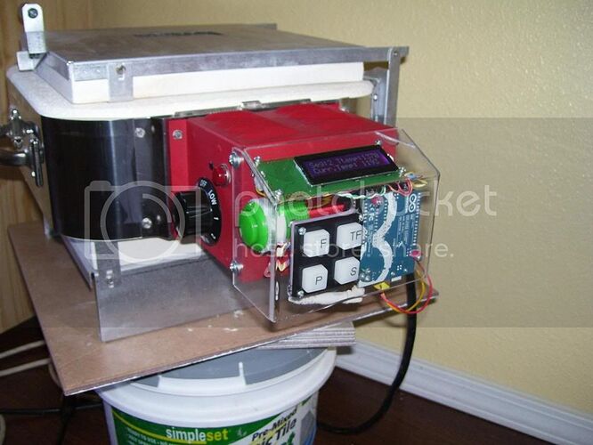

I did finished it up on Sunday. My wife loves it
I am not a EE or anything so dont have a schematics.
I used the MAX6675 from here http://ryanjmclaughlin.com/store/featured/nulzg.html with his library. I was able to wire in my switches and a transistor to run the SSR using that shield.
In the code I ended up using the PID beta6 library. The code follows the system96 glass fusing specs and does a decent job of doing it.
The final fused glass products look good.
Glenn

The SSR that I used is a Potter & BrumField T92P7D52-12 which is what was recommended by the company I got the original control mentioned in my first post.
Reasonably price at Digikey.
