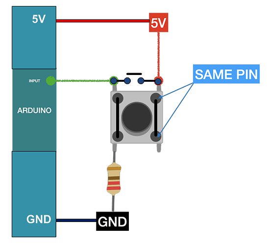

Do you have a pull down resistor for the buttons?
It’s better to connect the button to GND and use an input pull-up (the one directly available in your arduino - so no need for an extra resistor)
what i did is basically the 3 gnd of the buttons are connected to ground and the 5v are connected to a 220 resistor each and then connected to the positive then all those buttons have each pin for the arduino

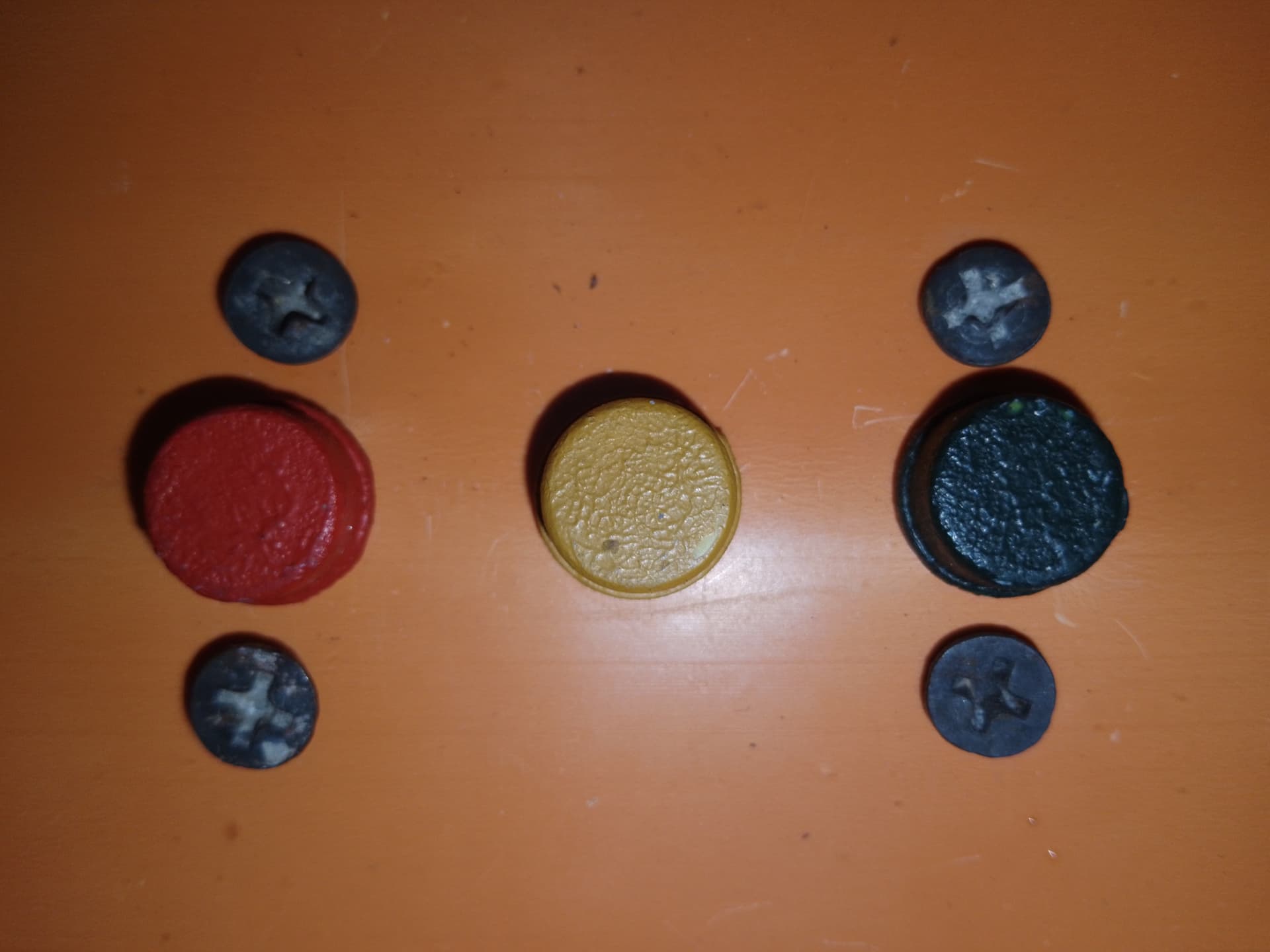

the screws are just there to keep them in place
I can't really tell what is what

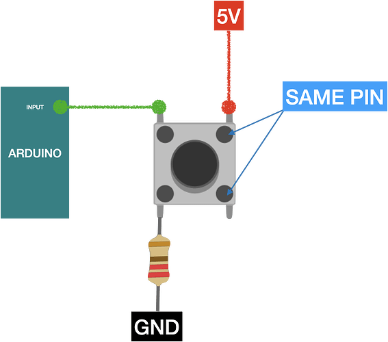

a pull down should be wired like this
if buttons have 4 legs, wire diagonally across the buttons to make sure you don't pick the connected pins by mistake.
how do i connect the diagonal?
with a resistor? if so should i remove the initial resistor?
what I mean is this
when you have 4 pins on your push button, you really have only 2 different ones. Internally they are connected. So if you want to be sure to include the switch in your circuit and not make use the same pin, you wire diagonally across the button and this way you are sure to not have an issue. (unless you really want to use the same pin).
we would typically not use a pull-down circuit with an extra resistor and wire 5V to the button (risk of short circuit if things go wrong). It's better to connect to GND and use a pullup. see https://docs.arduino.cc/tutorials/generic/digital-input-pullup/

I can’t tell from the picture you posted if you pulldown is correct
Does the wiring look like the one in post 26?
i cant really figure out because im not familiar with it could you send me a picture of a button with pulldown resistor?
does this help?
yes, GND being the GND of the Arduino was implicit
