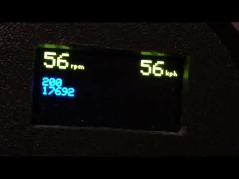

Here's a video of what I'm seeing:
I have configured 2 pin interrupts. One for RPM one for SPEED
They both read from the same frequency generator and both interrupts are configured exactly the same.
int1 seems to be get bad readings more often than int0, so I assumed it has to do with the priority of the interrupts.
Half way in the video, I connect int0 input wire to ground; only int1 receives the signal, but still bad readings.
I hope this helps explaining what my problem is.

I tried using the noInterrupts() while copying the RPMperiod to a temporary variable which then gets used in the rest of the program. In my code it doesn't make any difference; still having the random double frequency reading.
The fact the "noise" it's always exactly double my normal reading, regardless of input frequency, is really puzzling me. If it was caused by interrupts writing to the variable, shouldn't we expect more random numbers?
Both the RPM and SPEED are picked up from same source. Why is the problem more visible on the SPEED (int1) signal?

I continued stripping the program... when I removed the OLED display library and used the serial monitor to show the values, the problem finally went away!
At this point in time I'm sure that the <Adafruit_GFX.h> and/or <Adafruit_SSD1306.h> libraries for the OLED display are not "Interrupt friendly"; or at least not the way I'm using it.
Somebody smarter then me can figure out why :slight_smile:
