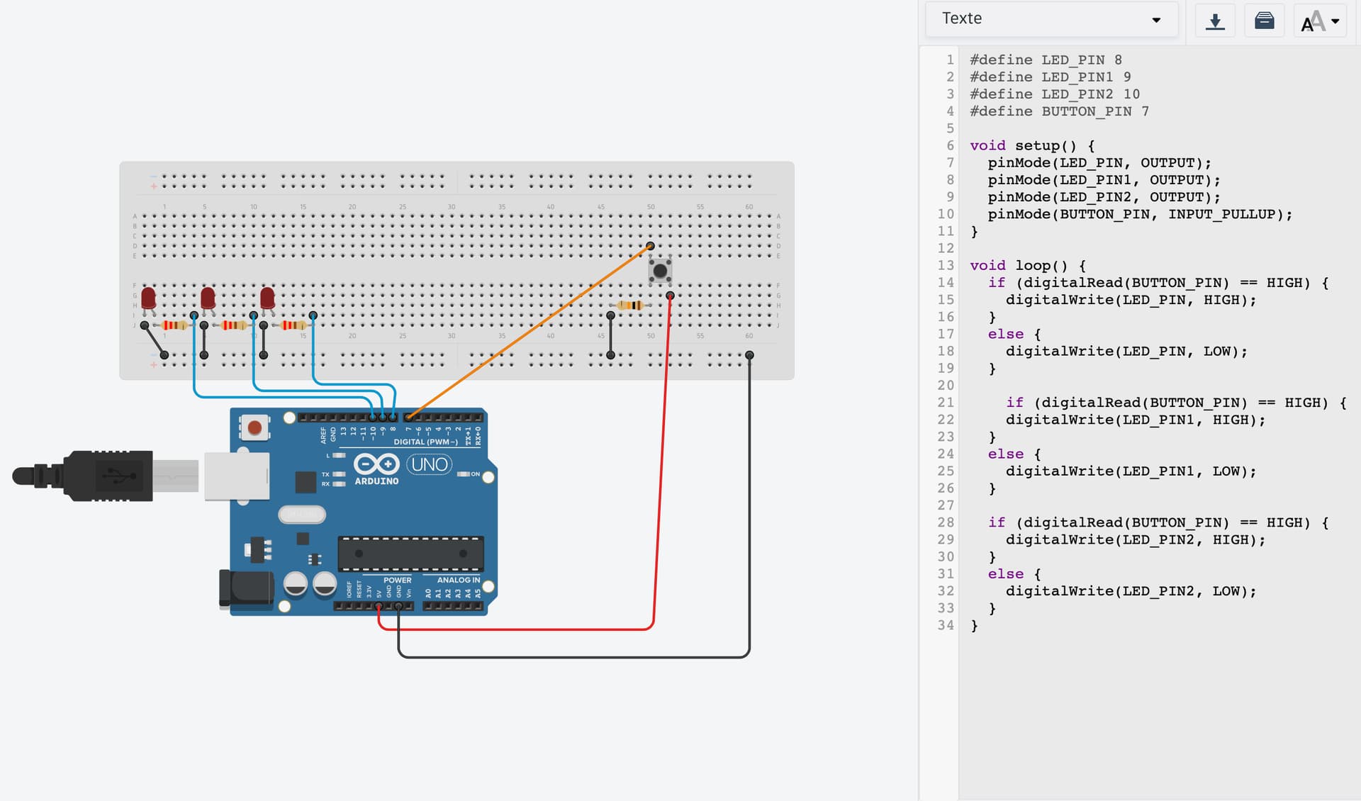

Hi guys, I'm new in the programing field and I'm trying to light 1 random led out of 3 by pushing a button. So that when the button's pressed on led turn on randomly, when I release the button it turns off, and the next time another leds turns on randomly.
Here's my code so far. I know there is just 2 Leds for now…
#define LED_PIN 8
#define LED_PIN1 9
#define BUTTON_PIN 7
  pinMode(LED_PIN, OUTPUT);
  pinMode(LED_PIN1, OUTPUT);
  pinMode(BUTTON_PIN, INPUT);
  if (digitalRead(BUTTON_PIN) == HIGH) {
    digitalWrite(LED_PIN, HIGH);
  else {
    digitalWrite(LED_PIN, LOW);
    digitalWrite(LED_PIN1, HIGH);
  else {
    digitalWrite(LED_PIN1, LOW);
Can anyone help me, thanks guys

Do I absolutely have to use INPUT_PULLUP as I already wired an external resistor between one leg of the button to VCC and so the default state for the button is HIGH, and when I press it, its states goes to LOW ?
It is OK to use an external pullup resistor rather than INPUT_PULLUP.
How are your LEDs wired ? Do they turn on when the LED pin goes HIGH or when it goes LOW ?
Please post a schematic of your project showing how all of the components are connected and powered. A 'photo of a hand drawn circuit is good enough
I ended up using INPUT_PULLUP
But presumably not with that circuit

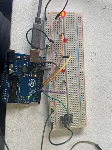

Okay so after many hours deep into forums I managed to make it work.
I'm sure the code is messy and not really professional…but it works for now. I'm gonna try to make it prettier.
It's composed of multiple parts of code put together, anyway the final code is below :

In the end I also used 3 Leds with 3 1K ohm Resistor and a button
And yes I'm working on that for a personal and school project. It's for my diploma project in order to graduate from my master in graphic design !
