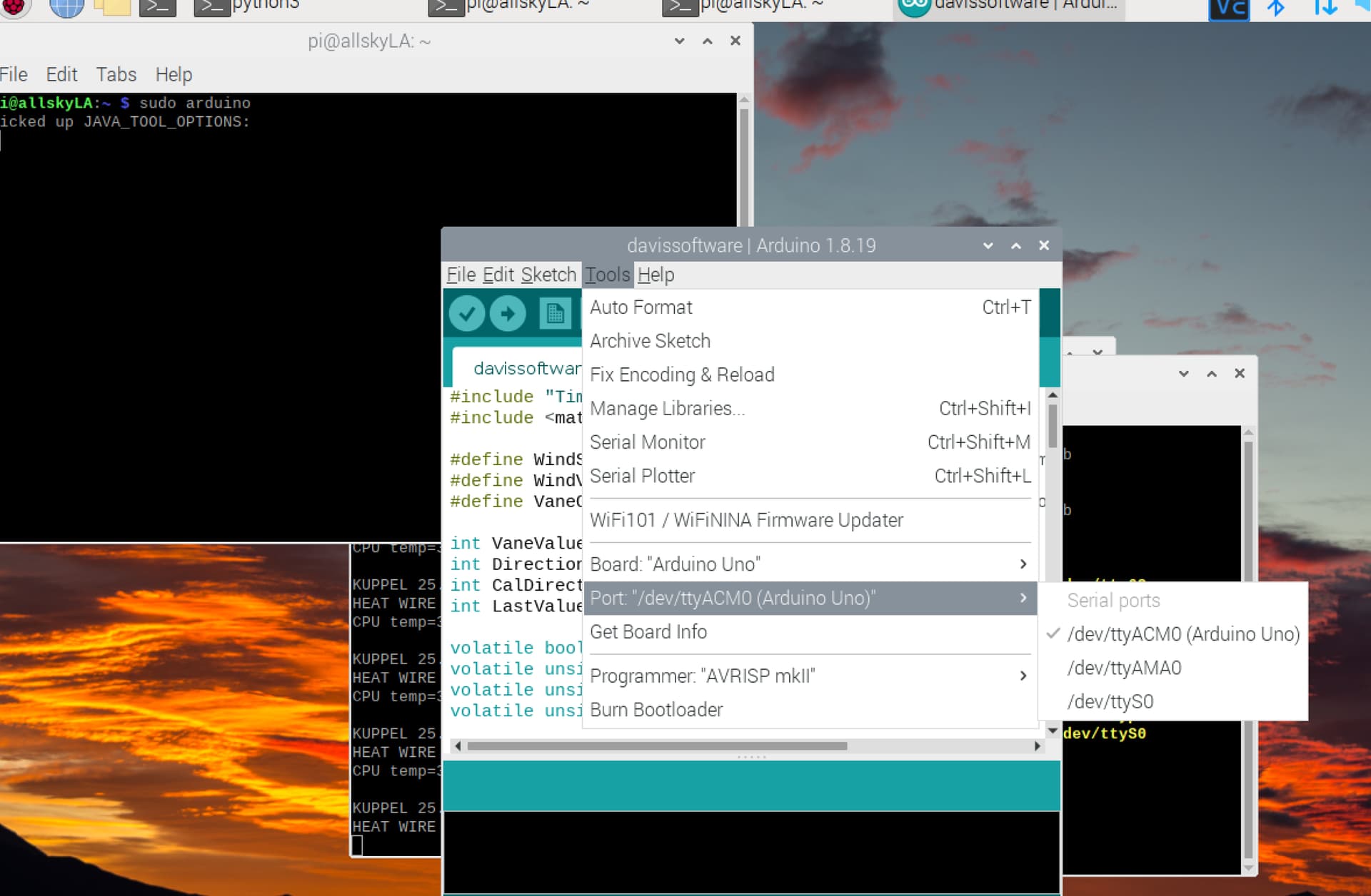

Hey Guys,
I connected my RPi4B serial via usb to my Arduino UNO.
Everything worked fine with ACM0 device. After rebooting/reconnecting/update the Port switched to AMA0 and the same setup with the same code isnt working.

An error occurred while uploading the sketch
avrdude: ser_open(): can't open device "/dev/ttyAMA0": Device or resource busy

unfortunalty i cant delete my post. i have no idea why, but the serial port in raspiberry config was turned off. now i have ttyS0 available, but its not syncing anymore..
If the issue is sloved, you can just flag the post that was most helpful as the solution (in this case your own post (#4) I guess).
finally! after 5hours i got it, damn - - only ACM0 works
