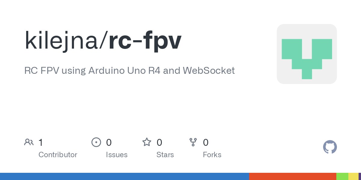

Just thought I'd post an update:
I gave up on my initial approach and had my partner help me write a Node.js application that hosts a local webpage which displays the FPV camera and uses event listeners for keypresses to send to the arduino.
You can find the software stack and more info in the readme.
You can find the repo here:
Will probably require rewriting some code for your application but hey, it works.
Hopefully this helps someone that had the same idea as me.
Cheers
