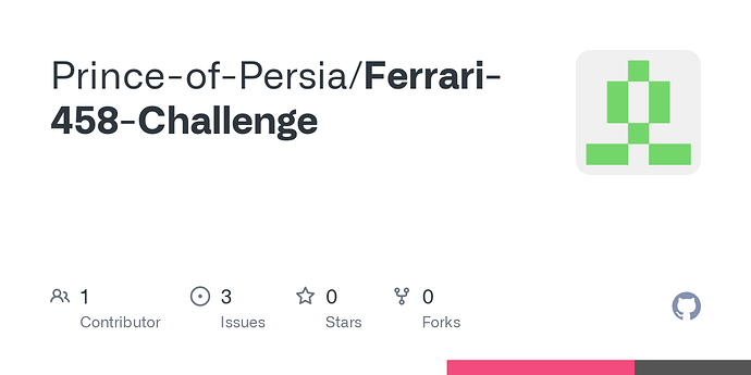

Hi @UKHeliBob,
thanks for the example code!!
I'm upgrading my RC car to use micro controllers and make a AutoPilot version of it soon.
I have my code on git hub f you want to have a look:
I'm using a 6 channel radio to control the car and accessories like Lights etc. At the moment i'm working on the program lag. have prototyped a few boards but have problems with power management!!
As you mentioned interrupts stop the program till their done! So i was thinking to have a micro controller reading the channels constantly and pack them in the serial buffer and the second micro controller execute the rest of the code.
In the next phase there will be a third micro controller reading all the sensor values and doing the same.
please look at my repositories @ https://github.com/AmirRajabifar
@MarkT I added the fore loops but the readings from the channels are not VALID!!!
