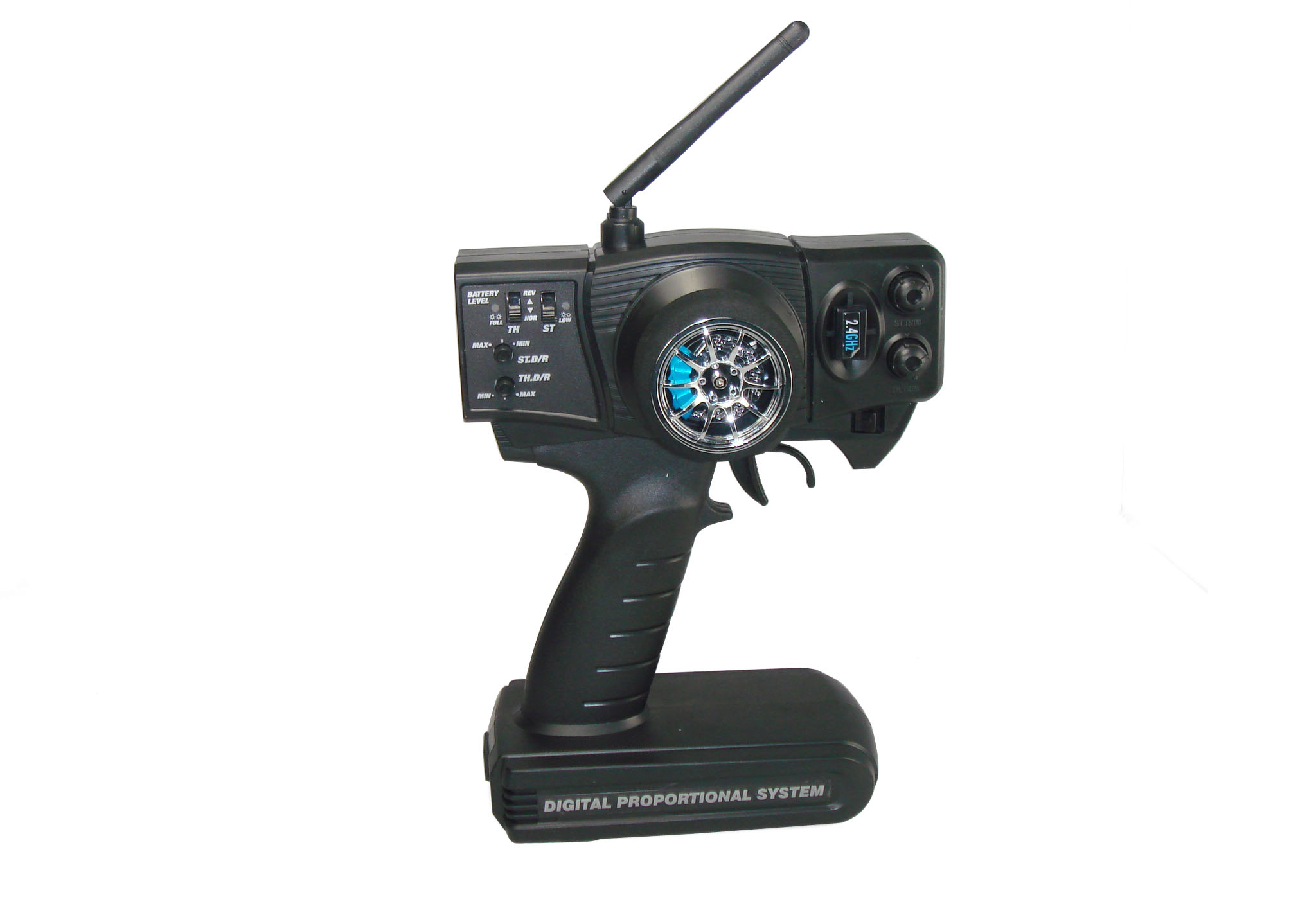

vinceherman:
Previously my team has been using the Spektrum dx4c controller for competitions but I don't know if this could be programmed with Arduino so I wanted to go for an option I knew people can do and help me with if needed. Although I'm open to other suggestions if they will work better than the PlayStation controller.
This here is a pic of the controller we have been using.
Is there a way to be able to read the joysticks precisely. I was thinking of using something along the lines of that the joystick in its standard position (centralised) is straight, wheels are straight, and that as you move the joytick to left or right this is measured in the serial monitor and then you grab these values in another line of coding to control the servos. Is this possible?
