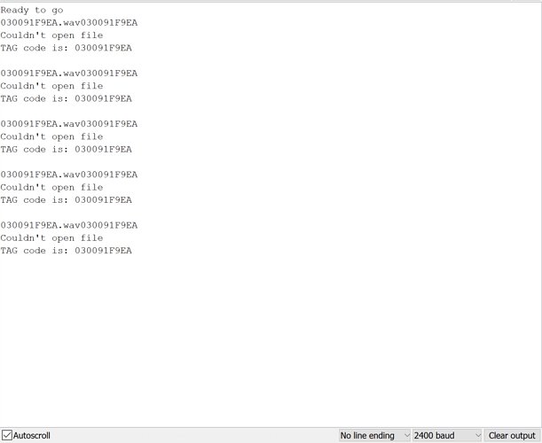

Specifically, in the playsound() method is where my problem begins. After the 13th column it seems to append more char's to the char array "filename" after the declared size of the column.
Output:
Ready to go
030091F9EA.wav030091F9EA
Couldn't open file
But when I use the while loop in my edited code I get:
Ready to go
030091F9EA.wavCouldn't open file

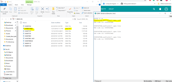

This gets me the desired name for the audio file, but it does not play the audio file on the SD card.
I will attach a picture for that.
My question is: Is it possible to have it read all 10 HEX values or do I have to stick to 8? with 8 it does not append after the declared column size.

So I got rid of the 2d array and made it: char filename[14];
void playsound(char codetoplay[]) {
  for(int i = 0; i<10; i++) {    // Make a filename from the first 8 characters of the RFID tag number
    filename[i]=codetoplay[i];
  filename[10]='.';
  filename[11]='w';
  filename[12]='a';
  filename[13]='v';
  silence(); //shut down anything that is currently playing and close that file
  playfile(filename);
but that output gave me:
Couldn't open file
TAG code is: 030091F9EA
Then I changed it to char filename[15];
and the output gave me:

I've attached pictures of the serial output and what is on the SD card.
filename[10]='.';
  filename[11]='w';
  filename[12]='a';
  filename[13]='v';
Couldn't open file
In this case, with char filename[14] the is no Null terminator to the character array. When you initialize char filename[15] with global scope a 0 winds up in the [14] cell. You are better off explicitly adding it with

The file will play. This is also if I change the file name on the SD card. And if I put the stop tag on the reader the audio will stop.
when I change it to the 8 HEX values:
I have been focusing on the array and string handling problems and did not pay attention to the issue of playing the file from the sd card.
I'm not familiar with the sd libraries you are using, but do they support more than 8.3 (xxxxxxxx.xxx)filenames?
They may not be designed to support the long file names. That may be why the original code from makezine transforms the read data into a shorter filename with .wav.
