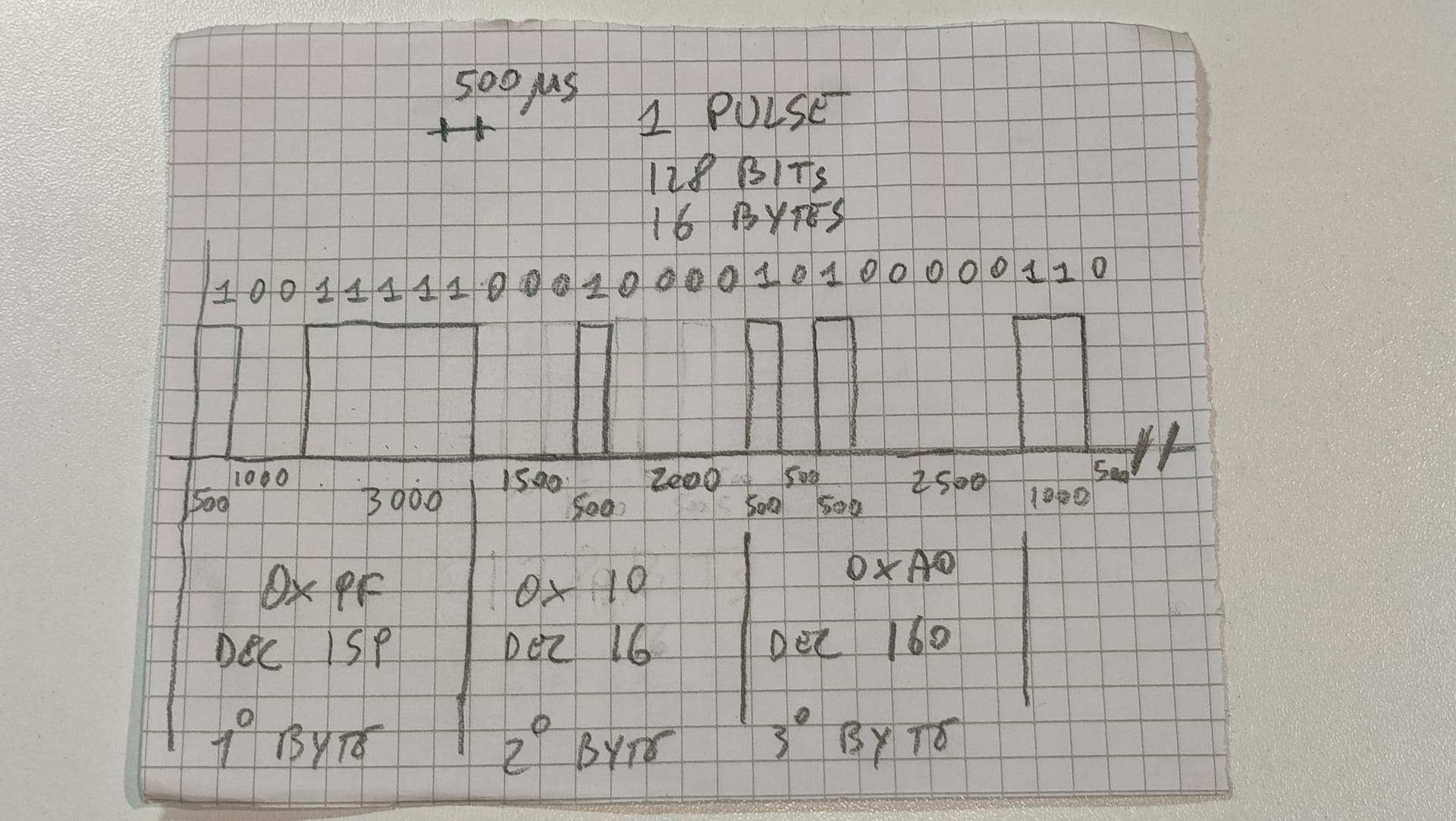

I have a train of 128 consecutive pulses of 500 microseconds each (16 bytes) and they are not spaced between one pulse and the other; I've tried various techniques to try to decode it, but I find it difficult to recognize the individual pulses when there are multiple consecutive bits at one or zero...

the pulses come from an RF transmitter that has its receiver integrated into a device; I would like to intercept the data to integrate it into my system. The protocol is proprietary, I can't trace it back to a standard, but the first byte identifies the device, the second indicates how many bytes the data is made up of and the last byte indicates the checksum. Therefore, out of 16 bytes there are 13 bytes of data + 3 of service...
I attach a diagram in which I inserted all the known data, I hope it helps...

That’s only thre bytes unfortunately,
From what you’re saying,there’s no sync gap or pause between each packet of bytes, so you have to be sure of the timing, or maybe there’s a separate clear & clock. like used with a chain of shift registers.

If there are only 3 to 5 you could use the timing-pattern of long/short pulses to identify which "data" this is
byte 1 is the length.
Is this always the same length of 16 bytes?
What do byte 2-16 represent?

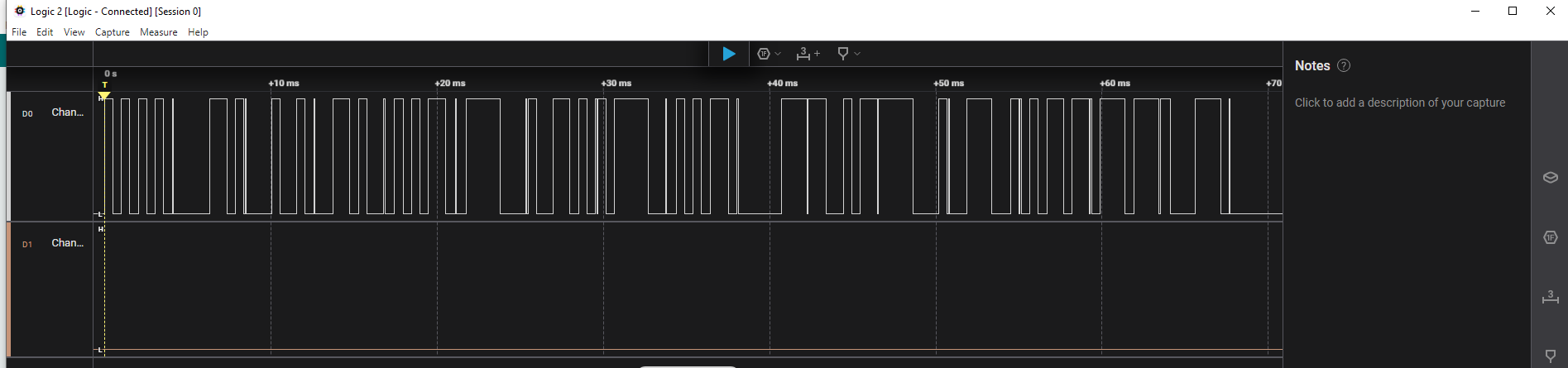

Update...

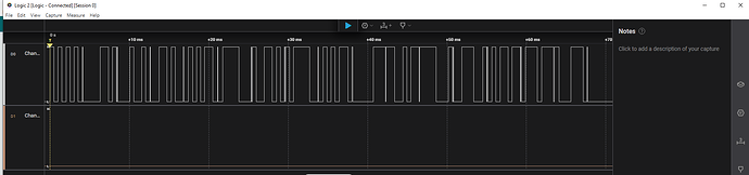

I attach the capture of a logic analyzer where you can actually see the entire sequence of 128 bits and in fact there is a pulse that indicates the end of each byte (72-76µs) that I was missing...
The first byte is fixed and identifies the device (and could be taken to synchronize), the second is the length of the data bytes that it will transmit (which could also be less than 13) and the last is a CRC.
In the capture the transmitted bytes are: AA,0D,12,34,56,78,9A,BC,56,07,CB,F1,39,5B,77,8E and the pulse is about 500µs (I saw that in the case of consecutive pulses of the same state the duration of each pulse can even reach 540-550µs each).
I hope this time I have given you all the information possible and I apologize for not having done so before.
Saver
if the first byte is the sequence of 4 wide, 10101010b, and one narrow pulse, it looks like each byte is ~5 msec, not 75usec.
that narrow pulse is more likely a start sequence with an equally narrow zero bit preceeding it, to distinguish it from the last data bit and followed by an equally narrow zero pulse immediately followed by a 8 bits of data. you can see this in the 7th byte, 0x9A, otherwise how do you detect the start of a byte such as 0x70 or 0x01
Guessing that each bit is 1 ~0.5msec, but the start sequence is smaller
Aha.
So a first approach could be to detect each rising and each falling edge
taking time-stamps on each edge.
Then calculating the time the pulse lasted high.
timestamp-of-falling-edge - timestamp-of-rising-edge
If it is just 72 to 76 microseconds you can conclude: end of byte-pulse
Then starting to sample the bits in the middle of the bit-time by using a timer-interrupt.
You should measure how many microseconds are there between falling.edge of the 75 µsec-pulse (the end-of-byte-pulse) and the rising-edge of bit 7 if this bit has value 1
you should measure the high-time of a lot of bits to obtain an average-value
How many microseconds are there from rising-edge of the end-of-byte-pulse
to rising edge of the
next end-of-byte-pulse?
With these timing-data you can setup a timer-interrupt-routine and start the timer at the right time for sampling the bit-values
ignoring the 75uSec start/end pulse the sequence {0xAA,0x0d,0x12,0x34,0x56} would look like (500uSec pulse width)

results similar to yours
ESP32 measure pins 16 and 17 pulse information
timerBegin() OK frequenmcy 1000000
displaying results
0 rise 3170969 fall 3171459 period 490 bits  count 1 1
fall 3171459 rise 3171956 period 497 bits  count 1 0
1 rise 3171956 fall 3172454 period 498 bits  count 1 1
fall 3172454 rise 3172952 period 498 bits  count 1 0
2 rise 3172952 fall 3173449 period 497 bits  count 1 1
fall 3173449 rise 3173947 period 498 bits  count 1 0
3 rise 3173947 fall 3174445 period 498 bits  count 1 1
fall 3174445 rise 3174944 period 499 bits  count 1 0
4 rise 3174944 fall 3175020 period 76 bits  count 0  datain 0xAA
fall 3175020 rise 3177154 period 2134 bits  count 4 0000
5 rise 3177154 fall 3178148 period 994 bits  count 2 11
fall 3178148 rise 3178645 period 497 bits  count 1 0
6 rise 3178645 fall 3179144 period 499 bits  count 1 1
fall 3179144 rise 3179220 period 76 bits  count 0  datain 0x0D
7 rise 3179220 fall 3179368 period 148 bits  count 0
fall 3179368 rise 3180862 period 1494 bits  count 3 000
8 rise 3180862 fall 3181360 period 498 bits  count 1 1
fall 3181360 rise 3182354 period 994 bits  count 2 00
9 rise 3182354 fall 3182851 period 497 bits  count 1 1
fall 3182851 rise 3183349 period 498 bits  count 1 0
10 rise 3183349 fall 3183425 period 76 bits  count 0  datain 0x12
fall 3183425 rise 3184564 period 1139 bits  count 2 00
11 rise 3184564 fall 3185559 period 995 bits  count 2 11
fall 3185559 rise 3186056 period 497 bits  count 1 0
12 rise 3186056 fall 3186553 period 497 bits  count 1 1
fall 3186553 rise 3187550 period 997 bits  count 2 00
13 rise 3187550 fall 3187627 period 77 bits  count 0  datain 0x34
fall 3187627 rise 3191754 period 4127 bits  count 8 00000000
14 rise 3191754 fall 3191829 period 75 bits  count 0  datain 0x00
fall 3191829 rise 3192471 period 642 bits  count 1 0
15 rise 3192471 fall 3192969 period 498 bits  count 1 1
fall 3192969 rise 3193467 period 498 bits  count 1 0
16 rise 3193467 fall 3193964 period 497 bits  count 1 1
fall 3193964 rise 3194462 period 498 bits  count 1 0
17 rise 3194462 fall 3195456 period 994 bits  count 2 11
fall 3195456 rise 3195955 period 499 bits  count 1 0
18 rise 3195955 fall 3196030 period 75 bits  count 0  datain 0x56
fall 3196030 rise 3196175 period 145 bits  count 0
19 rise 3196175 fall 3200156 period 3981 bits  count 8 11111111
fall 3200156 rise 3200232 period 76 bits  count 0  datain 0xFF
20 rise 3200232 fall 3200380 period 148 bits  count 0
fall 3200380 rise 3200878 period 498 bits  count 1 0
21 rise 3200878 fall 3202868 period 1990 bits  count 4 1111
fall 3202868 rise 3204362 period 1494 bits  count 3 000
22 rise 3204362 fall 3204437 period 75 bits  count 0  datain 0x78
fall 3204437 rise 3204581 period 144 bits  count 0
23 rise 3204581 fall 3205079 period 498 bits  count 1 1
fall 3205079 rise 3206074 period 995 bits  count 2 00
24 rise 3206074 fall 3207068 period 994 bits  count 2 11
fall 3207068 rise 3207566 period 498 bits  count 1 0
25 rise 3207566 fall 3208063 period 497 bits  count 1 1
fall 3208063 rise 3208561 period 498 bits  count 1 0
26 rise 3208561 fall 3208637 period 76 bits  count 0  datain 0x9A
fall 3208637 rise 3208782 period 145 bits  count 0
27 rise 3208782 fall 3209279 period 497 bits  count 1 1
fall 3209279 rise 3209776 period 497 bits  count 1 0
28 rise 3209776 fall 3211767 period 1991 bits  count 4 1111
fall 3211767 rise 3212762 period 995 bits  count 2 00
29 rise 3212762 fall 3212838 period 76 bits  count 0  datain 0xBC
fall 3212838 rise 3213482 period 644 bits  count 1 0
30 rise 3213482 fall 3213980 period 498 bits  count 1 1
fall 3213980 rise 3214477 period 497 bits  count 1 0
31 rise 3214477 fall 3214975 period 498 bits  count 1 1
fall 3214975 rise 3215472 period 497 bits  count 1 0
32 rise 3215472 fall 3216466 period 994 bits  count 2 11
fall 3216466 rise 3216965 period 499 bits  count 1 0
33 rise 3216965 fall 3217041 period 76 bits  count 0  datain 0x56
fall 3217041 rise 3219674 period 2633 bits  count 5 00000
34 rise 3219674 fall 3221168 period 1494 bits  count 3 111
fall 3221168 rise 3221244 period 76 bits  count 0  datain 0x07
35 rise 3221244 fall 3222388 period 1144 bits  count 2 11
fall 3222388 rise 3223382 period 994 bits  count 2 00
36 rise 3223382 fall 3223879 period 497 bits  count 1 1
fall 3223879 rise 3224377 period 498 bits  count 1 0
37 rise 3224377 fall 3225373 period 996 bits  count 2 11
fall 3225373 rise 3225449 period 76 bits  count 0  datain 0xCB
38 rise 3225449 fall 3227583 period 2134 bits  count 4 1111
fall 3227583 rise 3229076 period 1493 bits  count 3 000
39 rise 3229076 fall 3229574 period 498 bits  count 1 1
fall 3229574 rise 3229650 period 76 bits  count 0  datain 0xF1
40 rise 3229650 fall 3229726 period 76 bits  count 0
fall 3229726 rise 0 period -3229726 bits  count 2147483647
ERROR fall i 40 bit count 2147483647
data received 0xAA 0x0D 0x12 0x34 0x00 0x56 0xFF 0x78 0x9A 0xBC 0x56 0x07 0xCB 0xF1
