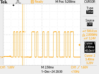

Reading a pulse train
ignoring the 75uSec start/end pulse the sequence {0xAA,0x0d,0x12,0x34,0x56} would look like (500uSec pulse width)
this may give you some ideas (for a ESP32)

pulse sequences give serial monitor output
ESP32 measure pins 16 and 17 pulse information
timerBegin() OK frequenmcy 1000000
displaying results

pulse width counters 1111111521131213211311112
bit pattern 101010100000110100010010001101000101011
