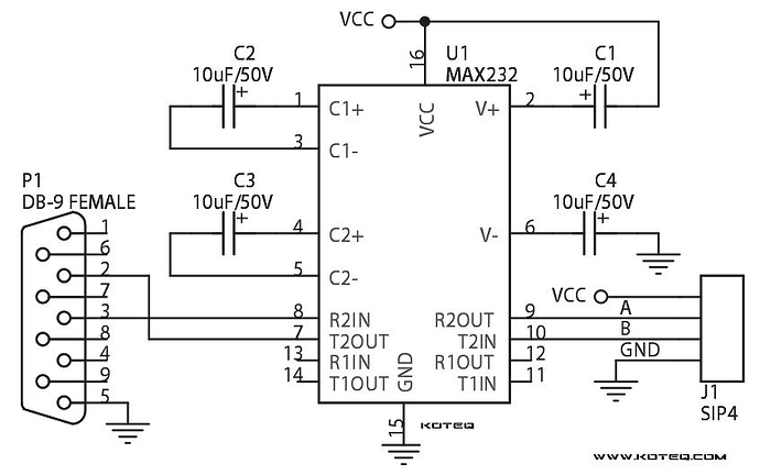

3. Schematic diagram of TTL <-----> RS232 Converter Module.
Figure-3:

(3) With a multi-meter find "plus side (+)" of C1 (+10V). Solder one side of a jumper wire at the "plus side' of C1 and connect other side of the jumper wire with Pin-16 of 4052.
(4) With a multi-meter find "minus side ( - )" of C4 (-10V). Solder one side of a jumper wire at the "minus sid" of C4 and connect other side of the jumper wire with Pin-7 of 4052.
