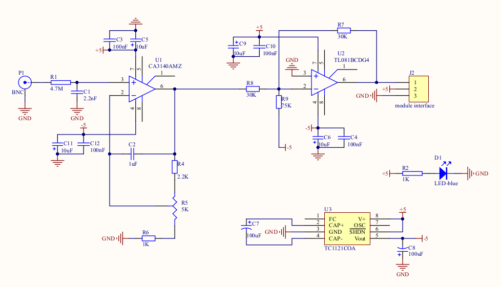

I can't find a schematic of the pH sensor :slightly_frowning_face: Does it output an absolute voltage ? then it is an execption.

Thanks, the output of the pH module is a voltage directly amplified from the pH probe. That is indeed a voltage. So you need to know the VCC :grimacing:
In these situations, Adafruit sometimes connects the AREF pin to the 3.3V output. Thus using the accuracy of the 3.3V voltage regulator as an external reference.
Tip: There are many problems with a pH sensor. If a aquarium is grounded or if there is a other sensor in the water, then the pH sensor does no longer work well. In that case, a galvanic isolated pH module might help: https://www.tindie.com/products/rezahussain/dormant-labs-ph-module-v2/
